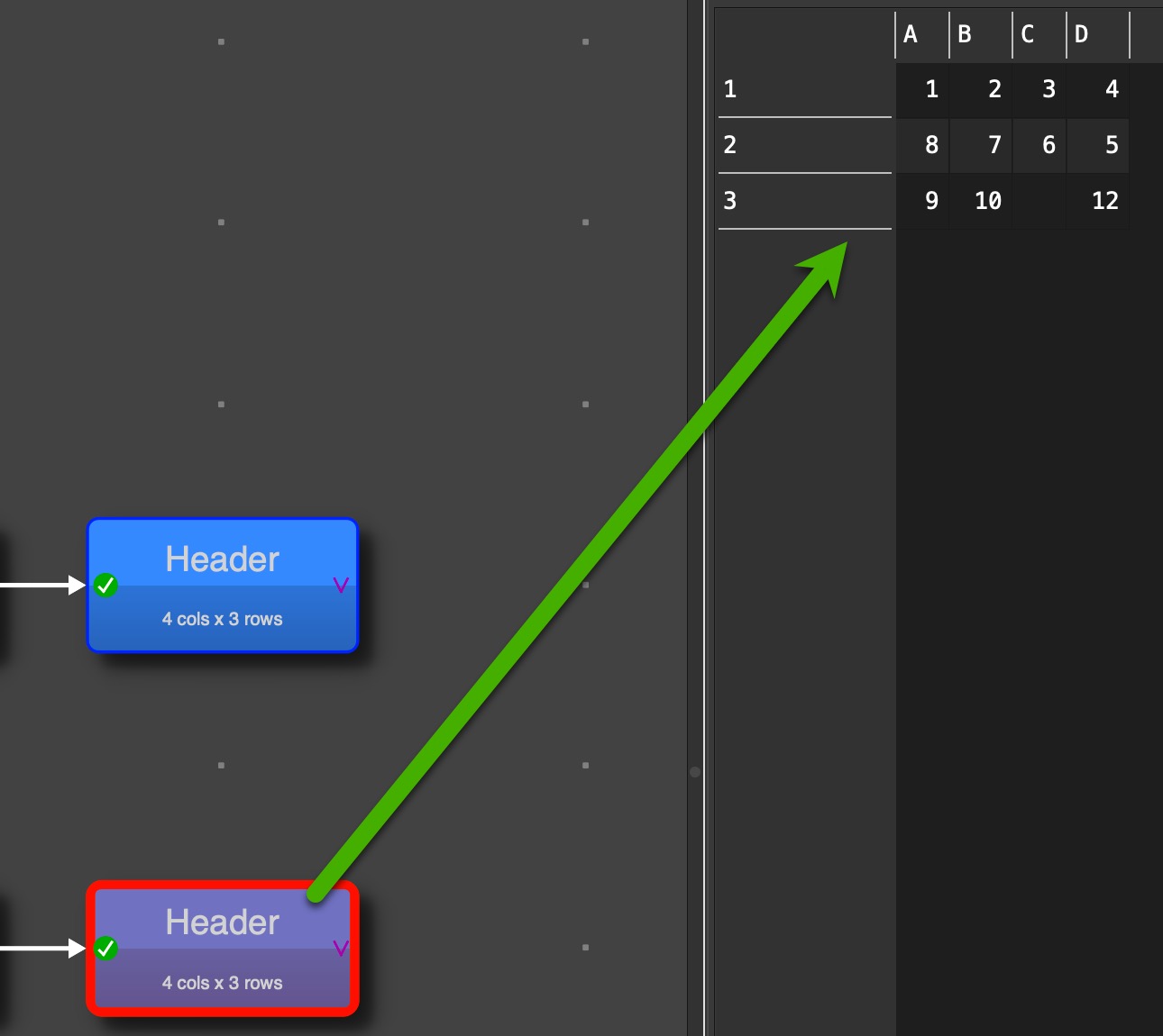

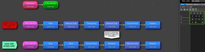

I played a little:
With the top 2 transformation I loaded a table and exported it to html. (first try was with al cell populated with values.
In the middle row I tried one process reading in the data as xml. It works but only if all cells of the table hold values.
The bottom row reads data as plain text, cut of file heads and bottom part and reorder the values. Both solutions require analysis of the file and adaptations might be required in case of different layouts and data. It is not a general solution for different html formats.

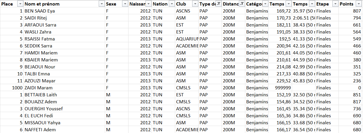

In my specific case, however, things are a bit more complex. The attached file (It’s a HTML file. I renamed it as a txt file to be able to upload it) contains the results of a swimming competition covering multiple events and age categories. My goal is to transform this file into a single consolidated table by incorporating the information contained in the section headers—such as the distance, stroke, gender, age category (Minimes, Cadets, Juniors/Seniors), and stage (Séries or finales)—into each corresponding results table, as shown in the header of the image below.
