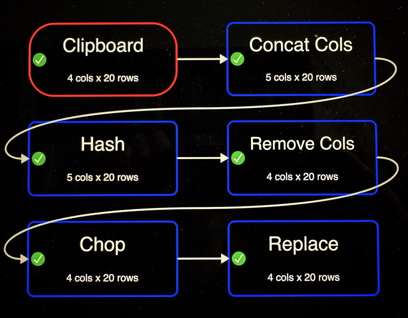

@Prashant, another query, if I may. Are file names duplicated in any single run to populate the ERP, even though duplicates may occur over time? If not, then you can create a hash from a concatenation of file name with metadata such as $(CurrentDateTime) or $(FileUpdatedDateTime), or both. That way no seed entry is needed and source length is sufficient for the hash to work well. A million images is only 2^20 so allowing birthday conditions you should still avoid collisions. If that is at all unclear I can write an example late today (Oz time).
Always appreciated !! Thank You in advance
Using bits of my earlier procedure with the Regex from Anonymous,
Combine data unique to this run with current date & time, so the combination will be unique across all runs. Hash that and reduce to desired character count then arrange formats.
It appears you can take only one Metadata item. Stamp would presumably work as well.
Unique ID.transform (3.7 KB)

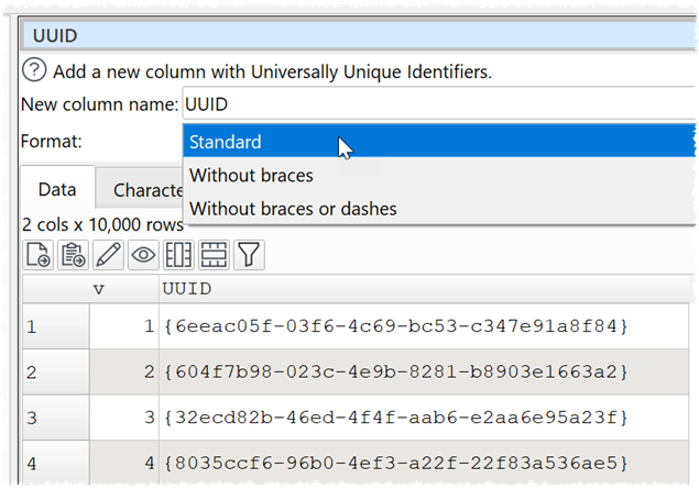

I did some experimenting and it looks like UUIDs/GUIDs are relatively straightforward to generate.
It uses DCE v4 (random) on Mac and Windows GUIDs on Windows. We don’t plan to support other variants of UUIDs.
The values generated are different each time you run the UUID transform and there is no way to control the values (no seed).
WOHOO !! Thanks , I love the touch of Without Braces option.
