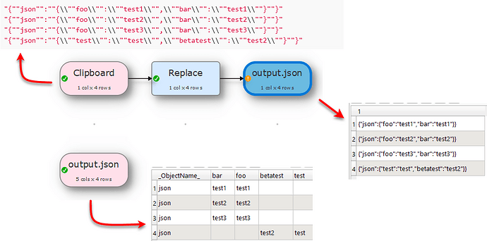

I can use the Replace transform to get this:
{"json":"{"foo":"test1","bar":"test1"}"}
But it isn’t valid JSON, according to https://jsonlint.com/.
But this is:
{"json":{"foo":"test1","bar":"test1"}}

If you can find a way to clean this up into valid JSON. I think the way to do this is to:
-Use Remove cols to make a dataset with just this column.
-Clean it up using Replace
-write it out as plain text to get a valid ‘JSON lines’ format file
-read it back in as JSON to form columns ‘foo’, ‘bar’ etc.
-use Row Num to add row numbers to this data and the original data
-Join the new dataset to the old dataset using the row number as a key
https://www.easydatatransform.com/help/latest/windows/html/index.html?json_format.html
Here it is,
Transform file.
TransformJasonColumnData.transform (3.3 KB)
