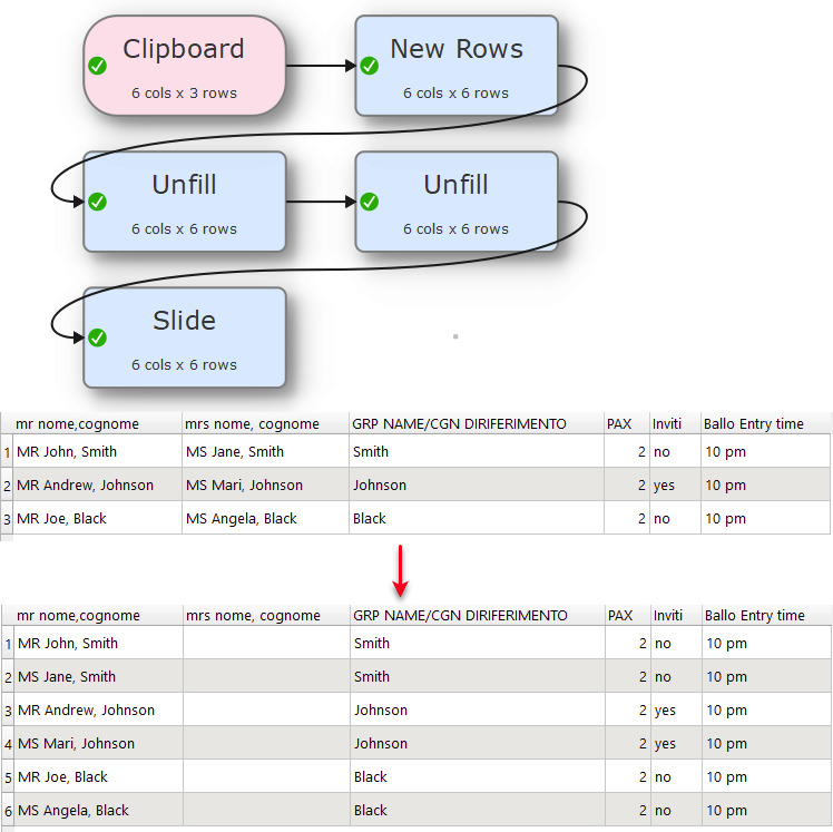

might not be the most elegant solution, but it works.
Transforms this table:
into
Stefano.transform (5.5 KB)

Here is another approach using Split Col into rows. Most of it is just deleting, reordering and renaming columns.
names.transform (3.8 KB)
had an idea for different solution:
Stefano2.transform (7.2 KB)
Just the order of rows is a different one.

After reading the whole thread, what I came to understand is that you have a sheet, where you want to bring the Mrs name down under the Mr name.
So my assumption is that all records are like such and no records are in correct order in the mix and if they are then to use my solution you need to have only records in the data that you need to fix.
Here is my take on it.
Transform file.
SplitingRows_without_Shifting.transform (3.4 KB)
