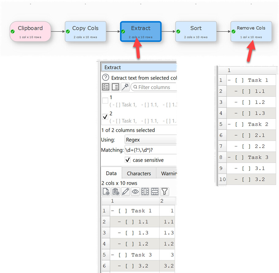

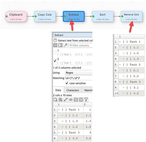

Thank you Monotone94. I am new to EDT. I can import the MD file as text. But I do not see which transforms to use to sort the tasks, both the tasks themselves keeping each subtask intact; and how to sort the subtasks. I would like to figure out most of this but I would appreciate some general direction to get started. Thank you again!
Thank you Andy! I will study that. But I was able to use the transform on a new file.
