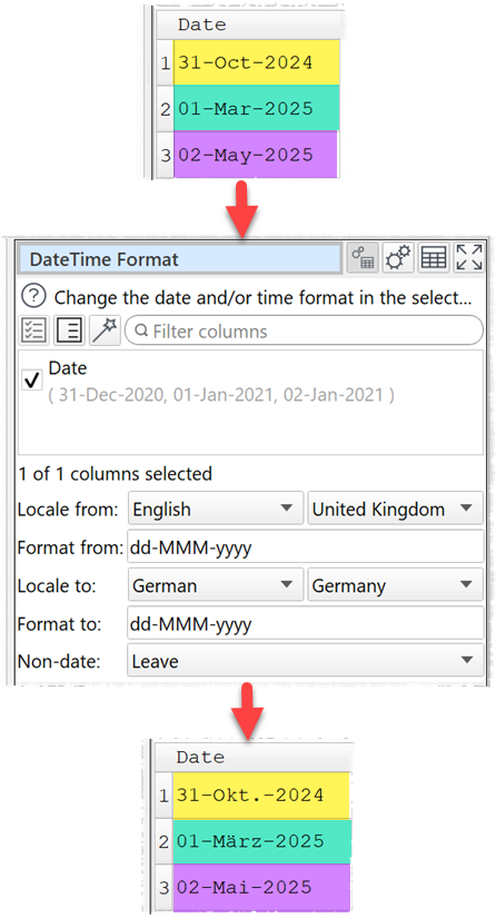

But a comment to the German example, if with the „German“ setting a default for the „Format to“ field is set, it should be different for Germany:
dd. MMM yyyy (01. März 2025 or 31. Okt. 2025) would be o.k for the long format. The Blanks between the blocks are intended.
dd.MM.yyyy (01.03.2025 or 31.10.2025) is the typical German notation for the short form.
We wouldn‘t use a format as shown in your result, at least I have never seen it.
Ok, thanks. I will amend the example.

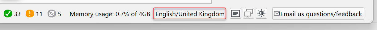

Until we have time to address this properly, I have added a reminder in the status bar:

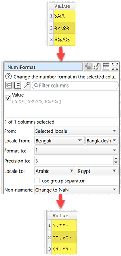

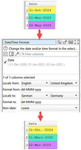

Also coming soon:
You can try the improvements to DateTime Format and Num Format transforms here:
Windows installer: https://www.easydatatransform.com/downloads/EasyDataTransform_2_6_1_snapshot_4.exe
Windows zip: https://www.easydatatransform.com/downloads/EasyDataTransform_Windows_2_6_1_snapshot_4.zip
Mac DMG: https://www.easydatatransform.com/downloads/EasyDataTransform_2_6_1_snapshot_4.dmg
Let us know if you have any feedback.

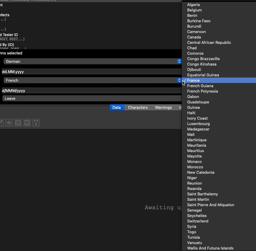

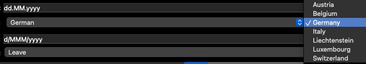

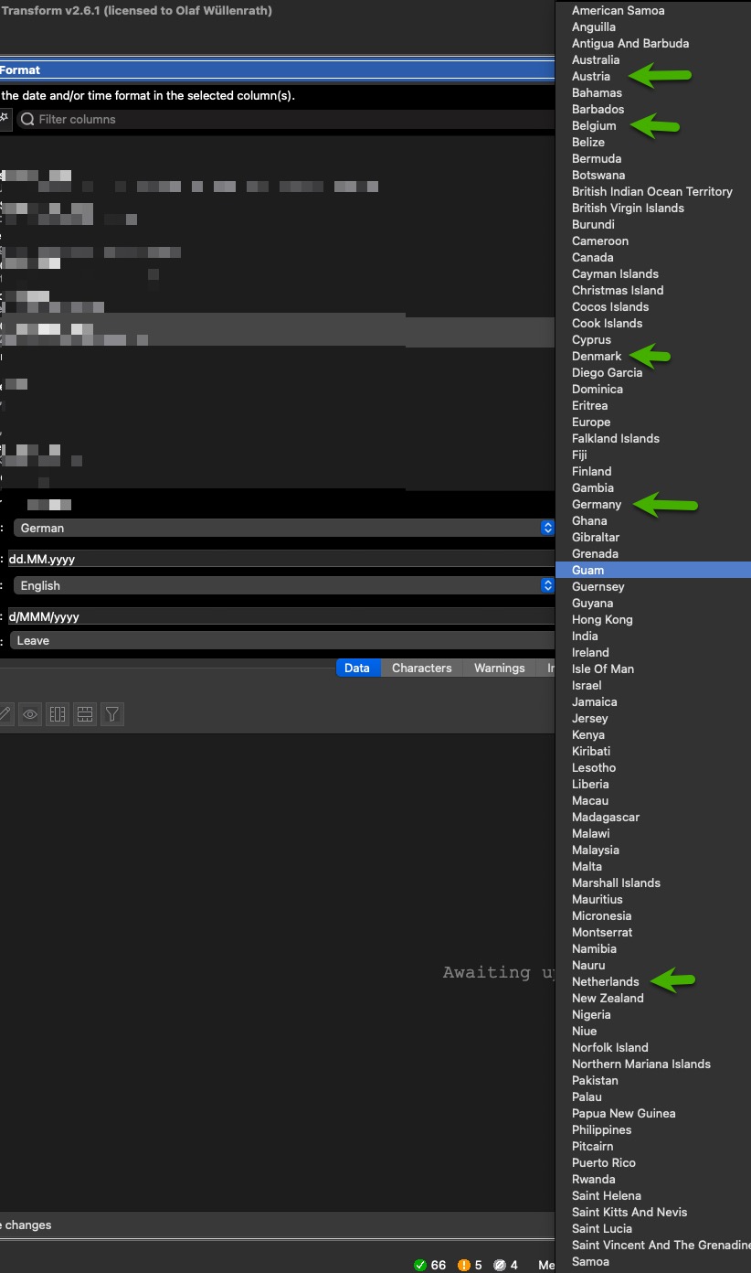

Hi Andy,
I had a look to the new format possibilities. First I identified that the Format to suggestion is not dependent on the choice of the Locale to selection. That thought was the main reason of my comment above.
I get the second selection possibilities for e.g. German
or French
But I wonder for the selection possibilities for English, e.g. the marked ones. I’m not aware that these countries (there might be more) have English as official language which might/can have own “dialects”. Do I miss something?
I’m not sure I understand. Are you suggesting that Format to should change as you change Locale to?
