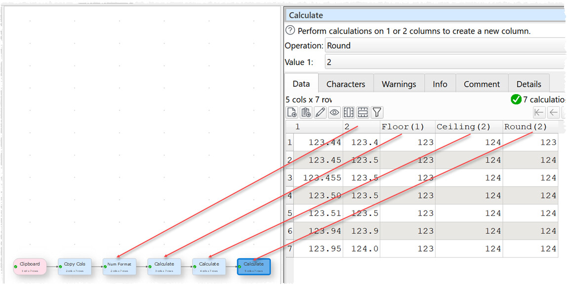

The current Round action on Calculate operation will perform rounding to the whole number only. I would like the option to specify the decimal places to round. So that if my data is 12.345, I can round this to 12.35 in one step.
(Yes, you can multiply the original number by 100, then use the current round feature, and then divide by 100. That is a lot of steps to perform something that would appear to be simple.)
As a nice to have, it would be good to offer “Round”, “Round Up”, and “Round Down”.
The Num Format transform rounds any which way. Except for the Round up or Round down.
AS @DanFeliciano says, you can use the Num format to round to a certain number of decimal places. Also you can use floor, ceil and round in the Calculate transform.
