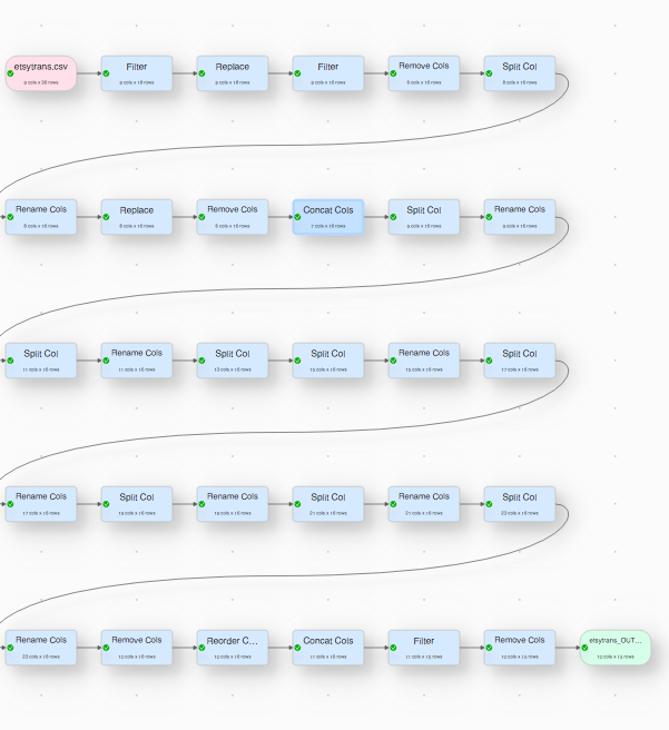

So Spread transformation didn’t work so I ended Concatenating the Transaction type and Amount columns and then using a chain of multiple Split transformations to get the individual values into individual columns I need and then rename the said columns into what I want them to show.
This works but there are many steps involved, in particular had to use the Rename Col step after every Split step otherwise the rename job will be difficult after many Split steps accumulate.
No need to do the workflow for me, just tell me what transformations I need and I’ll try first myself. If I have issues I’ll let you know.
This works, albeit it’s long…
