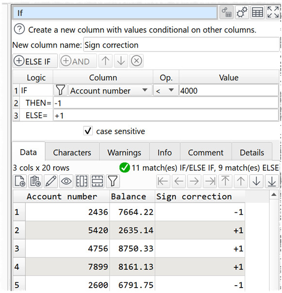

It would probably be a lot easier to use an If transform to create a new column with a value of -1 or +1. Then use Calculate to multiply by that new column to get the corrected value.

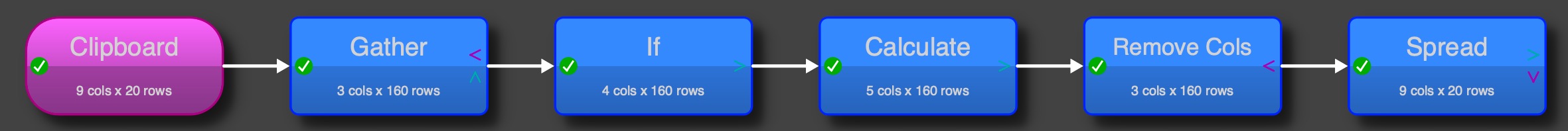

@egilDOTnet if it is just 8 balance columns you can do the calculate 8 times. If it would be more, Gather and Spread might be an option.
I simulated here with 8 columns for balances.
