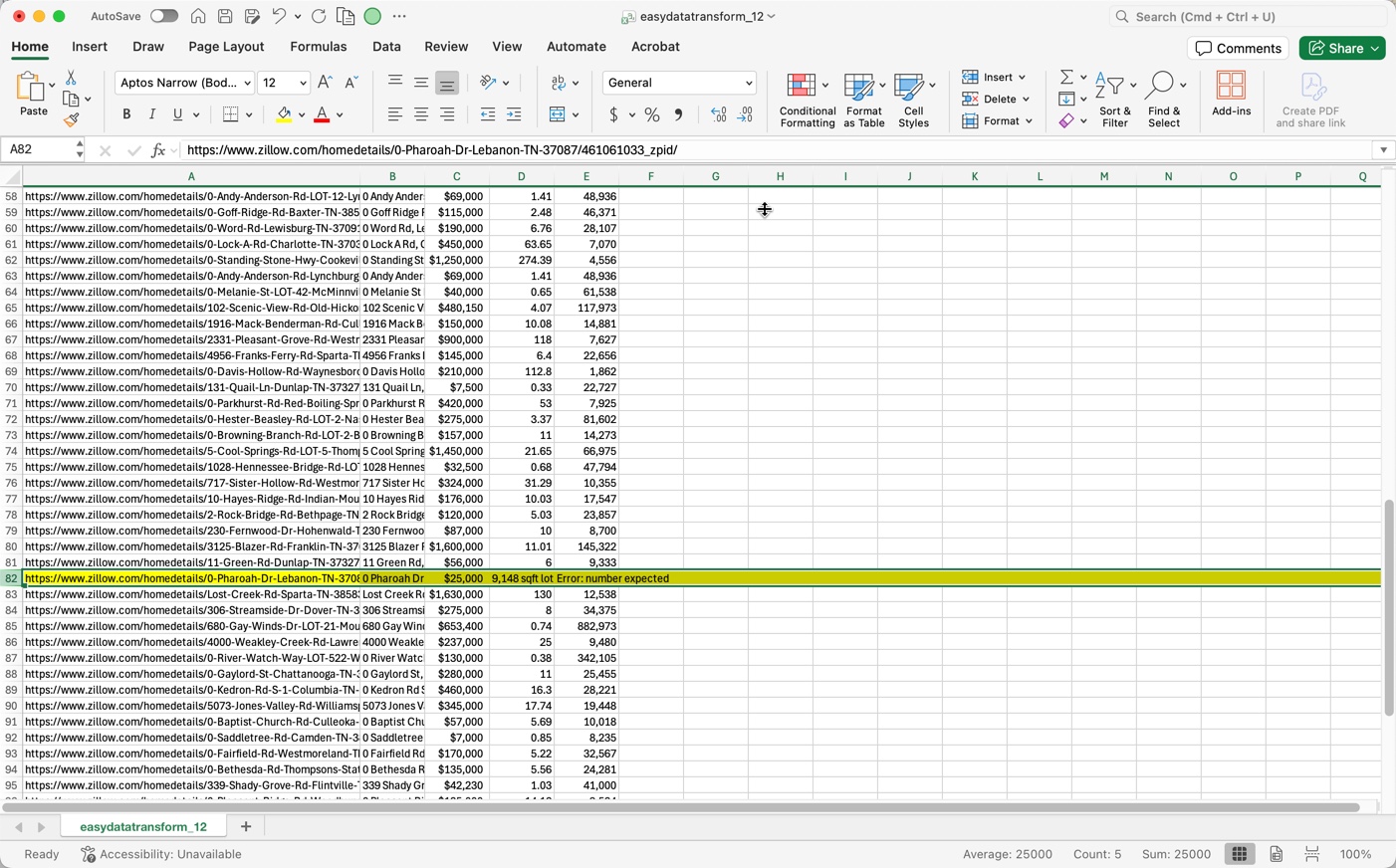

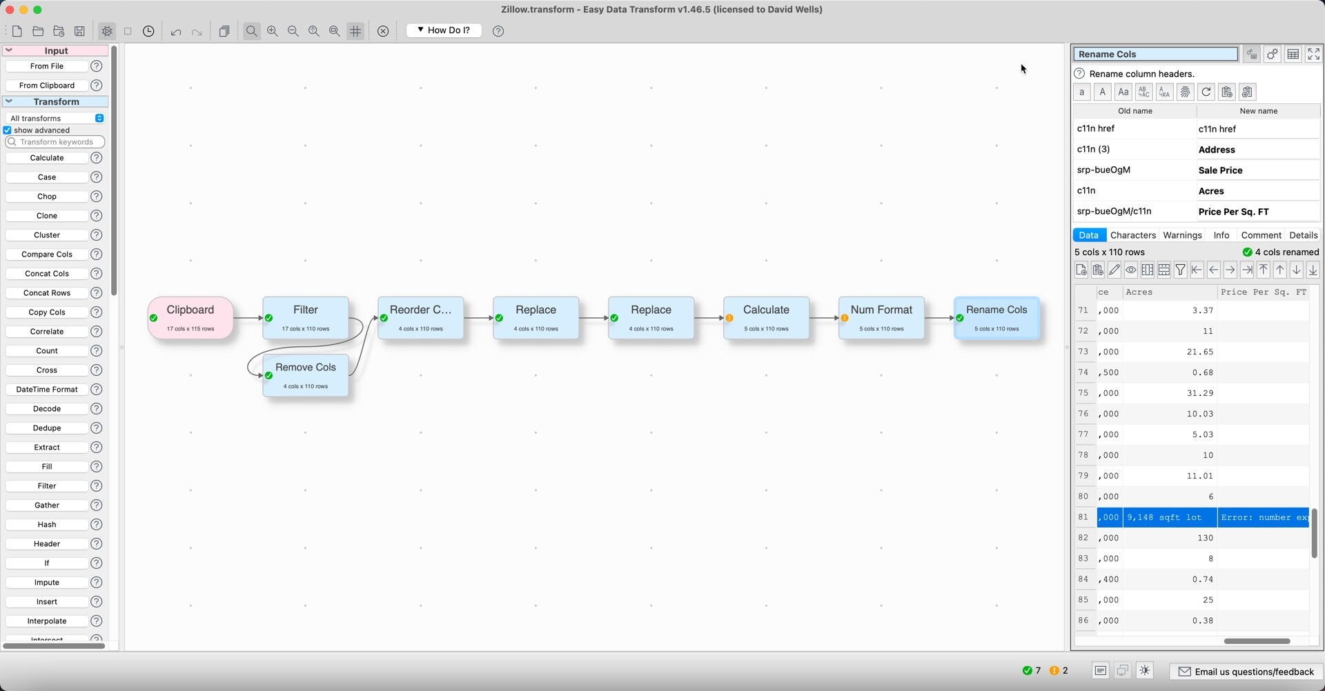

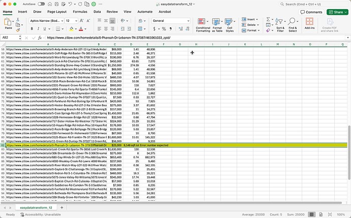

I created a transform for Zillow and I got stumped. Almost all of the rows showed acreage. One of the rows showed square feet. I need EDT to take any rows that shows the word square feet and do 2 things. I need it to remove the words square feet and then take the number that is in that row and divide that number by 43,560 to show the acreage. Can somebody help? Thank you.

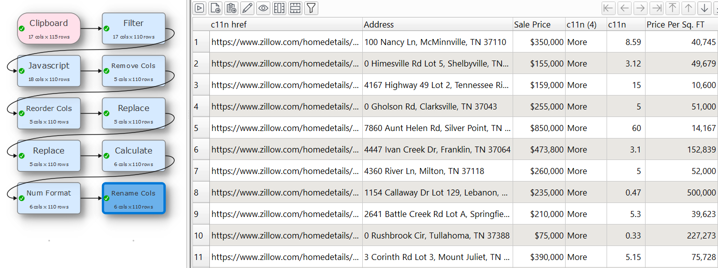

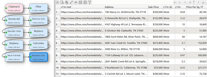

Here is another way of doing it using JavaScript Transform
Transform file.
Zillow_Updated.transform (84.2 KB)
