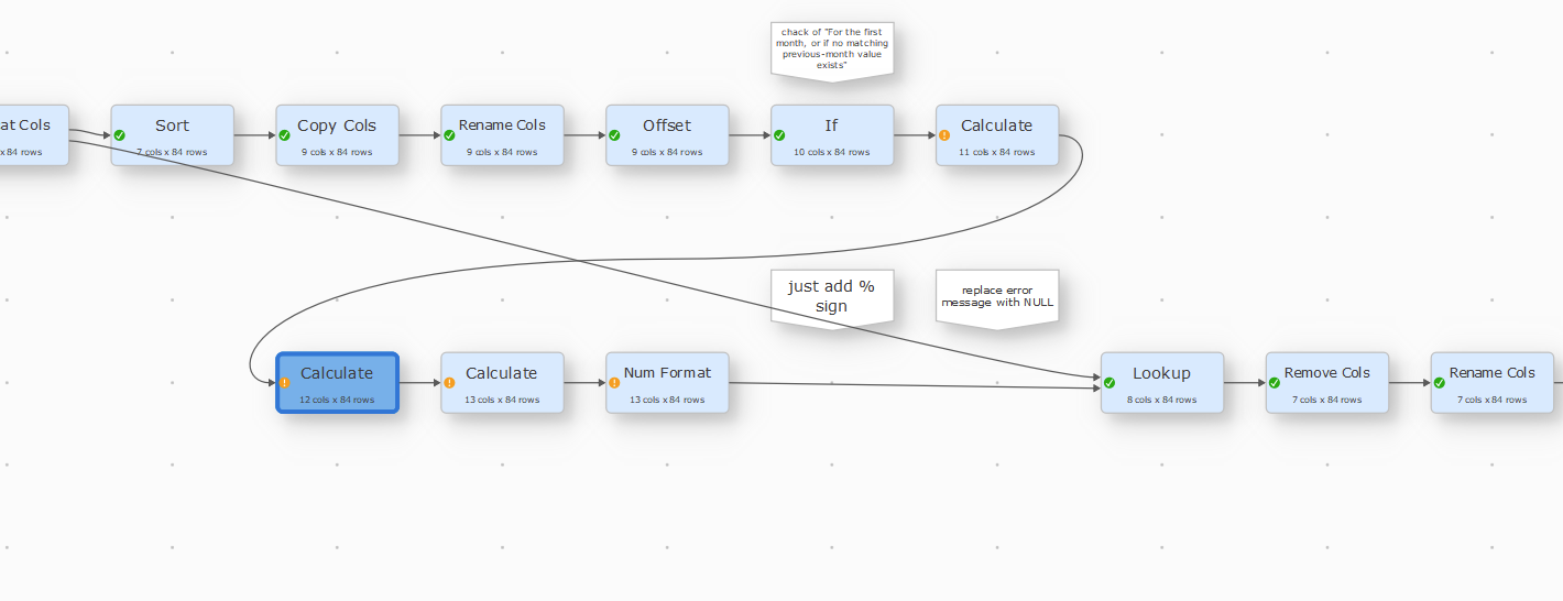

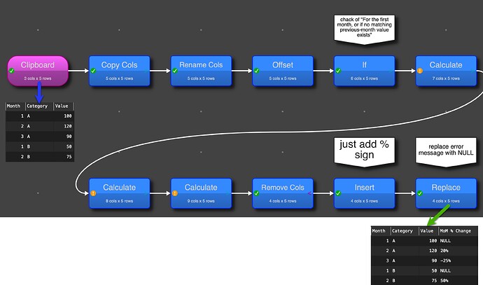

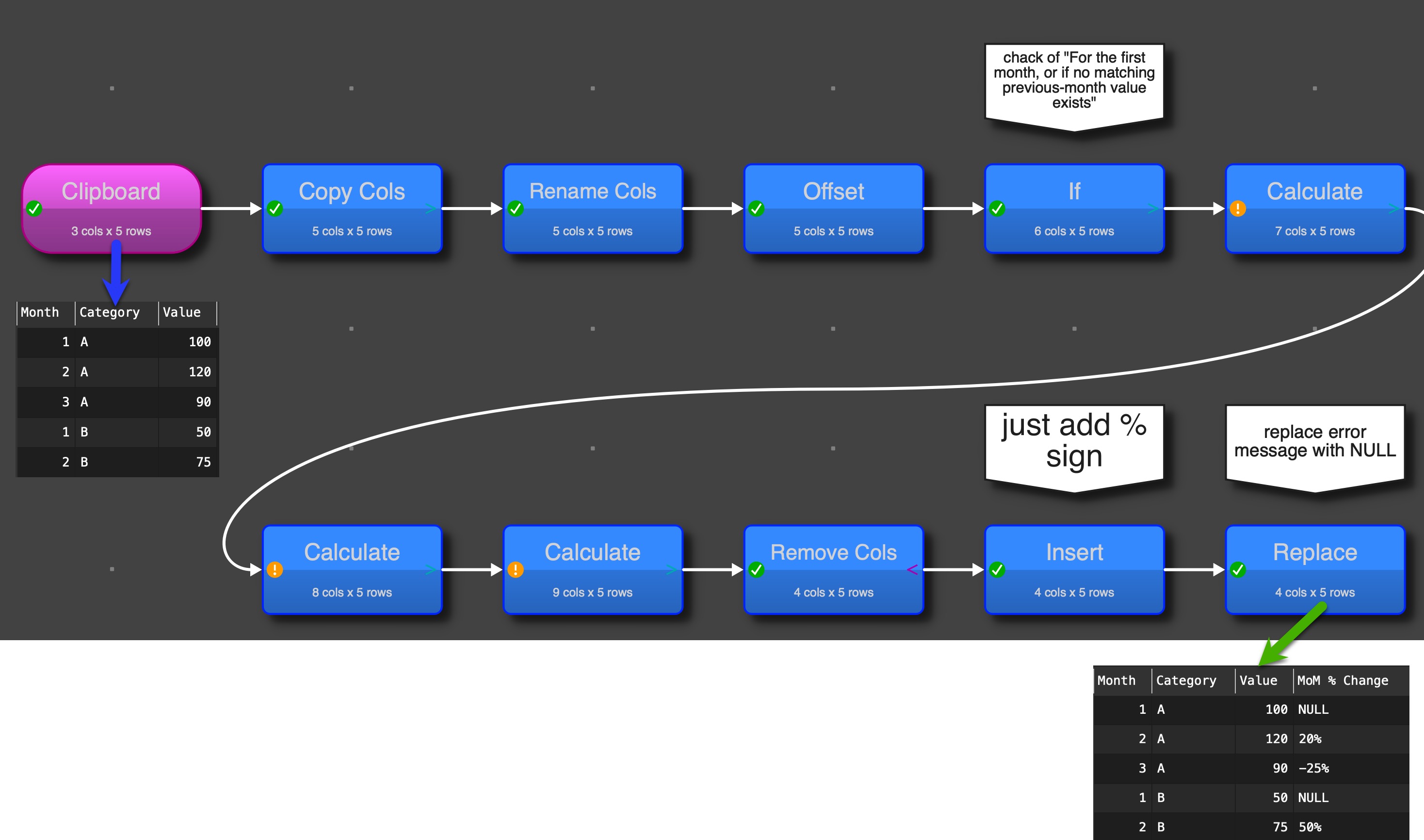

you can do it without new transformation, it isn’t straightforward (maybe there are faster ways). The main trick is the Offset transformation to move values up or down in different rows.
Phil MoM change.transform (6.9 KB)

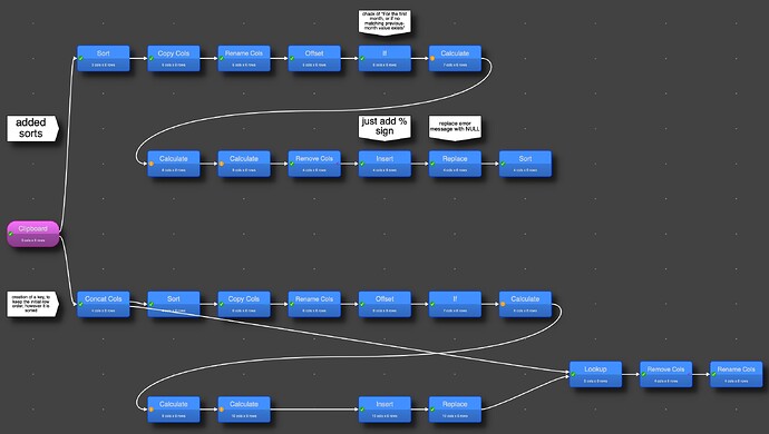

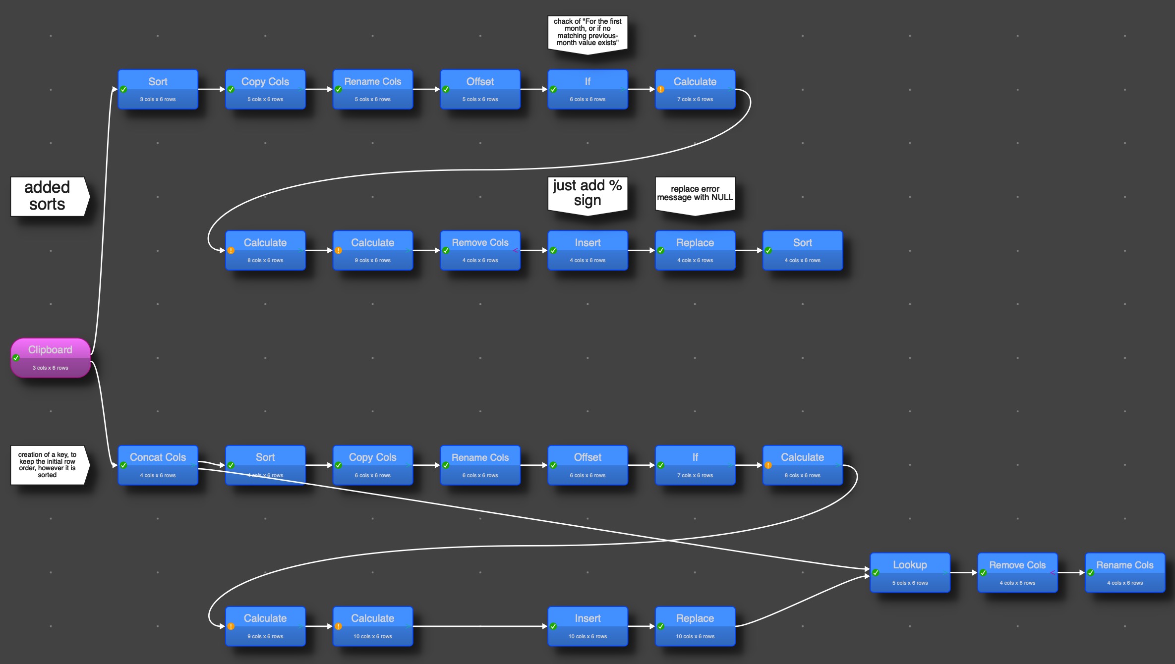

Two sort statements should solve it the first one a sort by Category and Month as second criteria (both Ascending). This should be done before the other logic. Second sort after calculation logic: Sort be Month and here Category as second criteria.
attached 2 solution, the upper part includes the sorts as stated in the reply before.
The bottom part created a key (with concat) and looks up the percentage later on, so the row order (whatever it might be is the same in the result.
Phil MoM change 2.transform (16.5 KB)

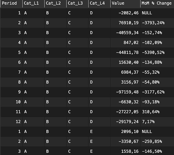

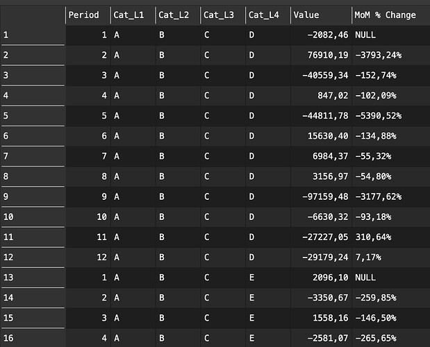

sample dataset.csv (1.7 KB) sure the essential columns are - Period, Cat_L4 and Value Thank you:)
And what rows are you getting an unexpected value at? What is the expected value?
I think it works correct, there is an issue with th exhuming values from negative to positive and vice versa. It will create percentages with changing signs and the jumps are large and show therefore percentages up in thousands.
And if you go from -10 to 20, you get a a percentage of -200%
the table shows a series of Values sorted by Cat_L4 and period.
Complete calculation in the transform file
Phil MoM change 3.transform (18.5 KB)

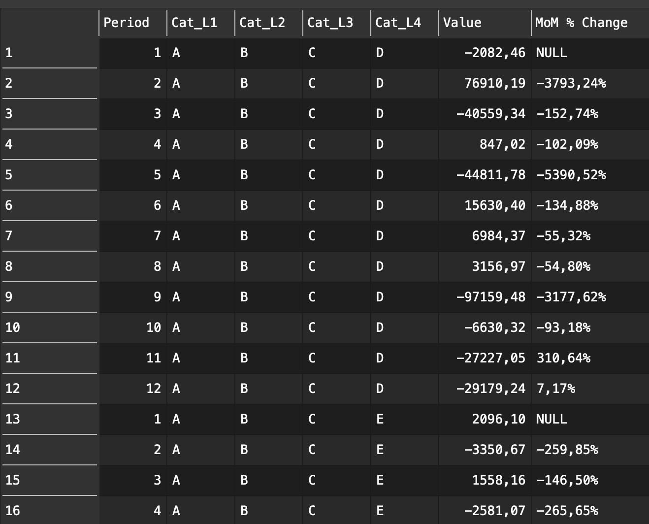

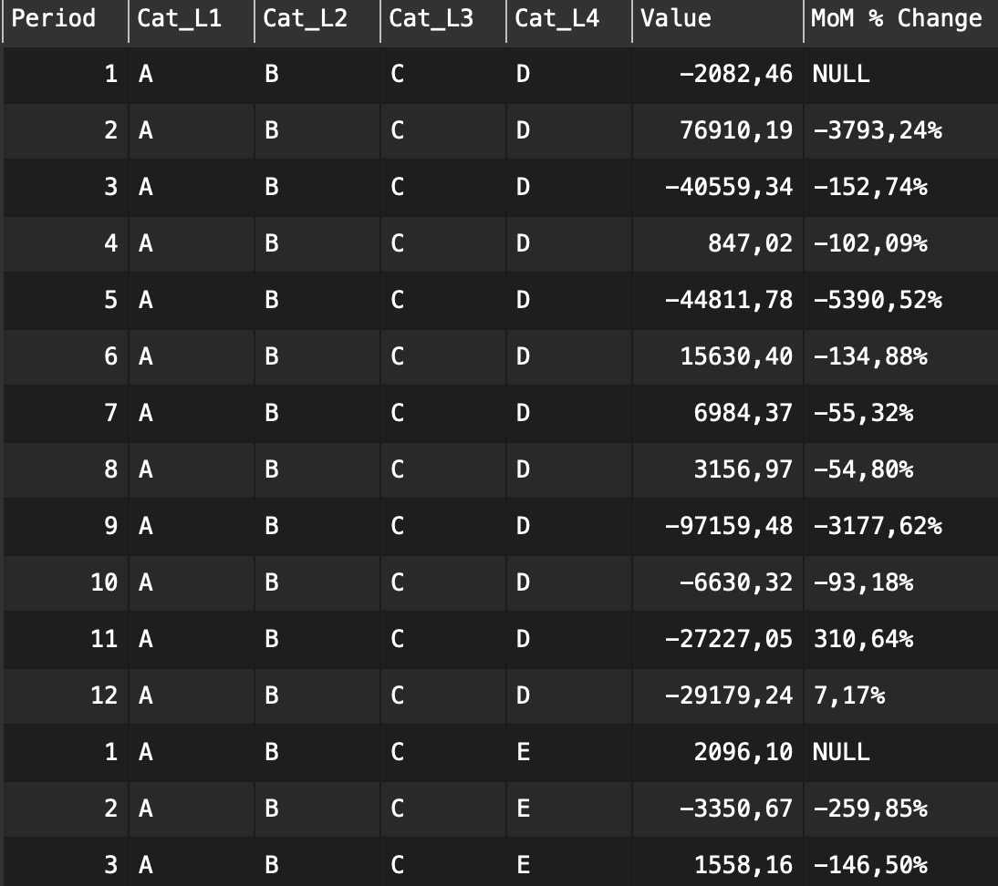

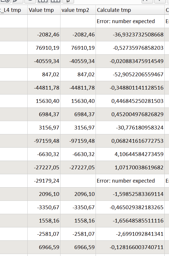

hi olaf, thanks again- i think i understand why the percentages were off look at the screenshot: the first calculations is correct: calculate tmp
nevertheless the calculation in my file were not according to your calculation:
I changed it (and there was an issue with column names) and it gives now (just the same, but now the formulas are according to the given one)
Phil MoM change 4.transform (18.5 KB)
thanks so much u are right- the right formula should be (current month/ previous month)*100 again dont trust always the AI….

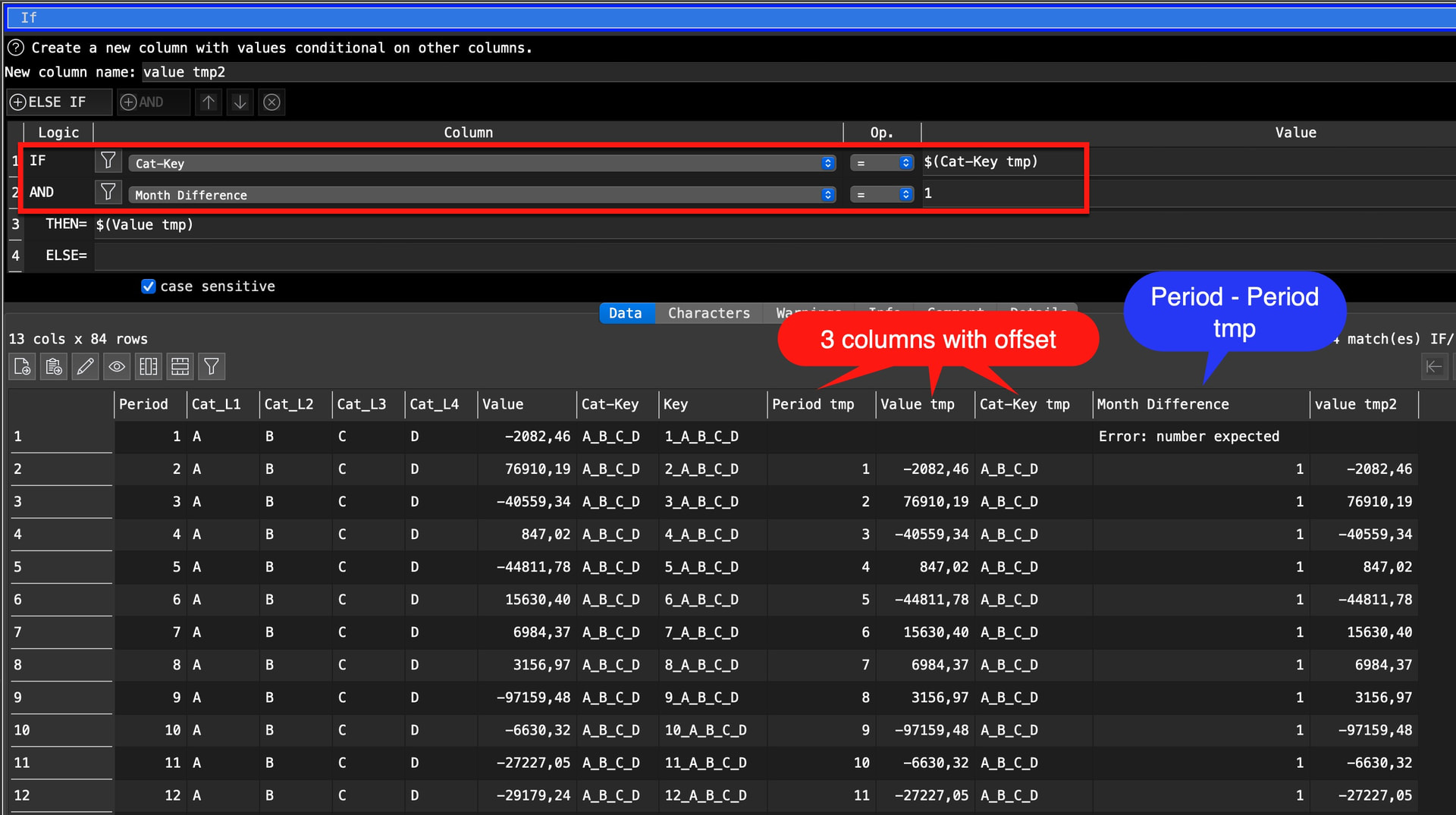

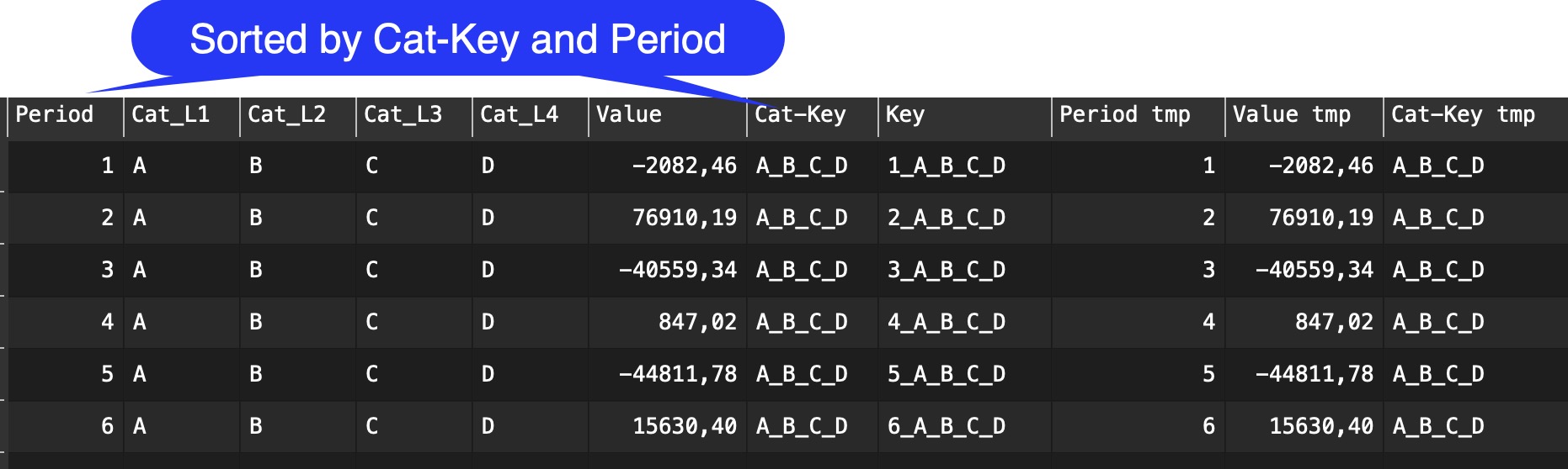

I understood before, the key ist Cat_L4. But I get your issue if the period sequence is broken. I think offset is still the right approach and only some adaptations are necessary.
I create now two keys with Concat Col and sort similar as before.One key is “Cat-Key” out of the 4 Lx values and the “Key” ist period plus all 4 Lx values.
Now the columns Period tmp (a copy of Period and the value and Cat-Key tmp column are moved with offset. Now a calculation is added (subtraction of Period - Period tmp). If this result is 1 it is a subsequent month. Therefore the if statement can be extended with an AND condition, so the value tmp2 is only populated if the Cat-Keys are identical AND it is a consequent month sequence.
The other percentage calculations are not touched (if required, I think you can do it by yourself).
Phil MoM change Key suggestion.transform (11.9 KB)
Thanks Olaf - for ur feedback i really appreciate- this way works very good as well
