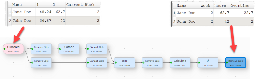

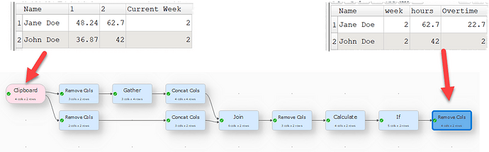

I think you can do what you want with Gather and Join.
overtime.transform (5.7 KB)

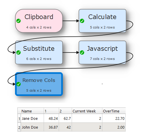

Here is my take on it.
Transform file.
JaveScriptReference.transform (2.9 KB)
Clever. Never thought of using the column variable like that.
