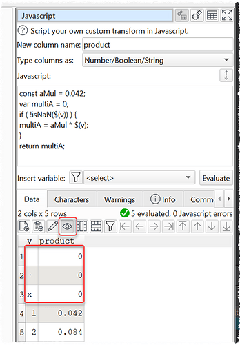

I tried to reproduce your issue, without success:
js-issue.transform (1.7 KB)
Can you post here a small example that reproduces the problem?

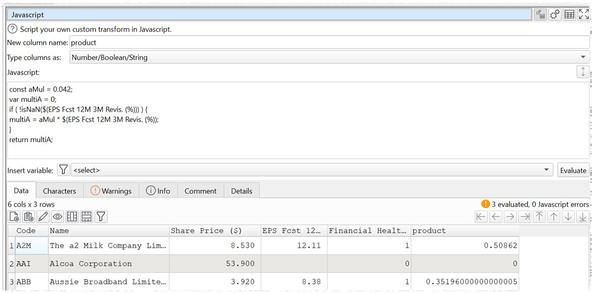

A sufficient sample of data for it to fail for me:
Code Name Share Price ($) EPS Fcst 12M 3M Revis. (%) Financial Health Rating
A2M The a2 Milk Company Limited 8.530 12.11 1
AAI Alcoa Corporation 53.900 0
ABB Aussie Broadband Limited 3.920 8.38 1
I copied your code back except for fixing references for this data. After running, the added column is filled with “undefined”. ‘Type columns’ is set to default Number/Boolean/String.
I tried inserting a Replace prior to the Javascript, replacing empty with 0 in the relevant columns. It worked as expected and the Javascript then ran without error. That is probably a sound solution although the failure is still odd

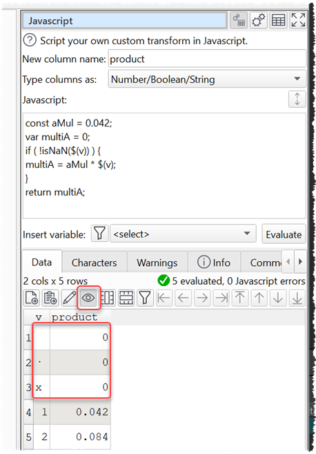

I had wondered if having $, ( and ) chars in the column names might be an issue. But that data still seems fine here:
Although it is possible some characters were lost/changed during copy and paste of the data.

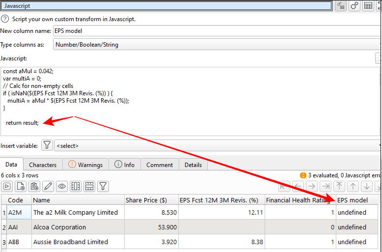

And here it is, why still undefined,
You are returning result which is not defined and assigned to any value.
Also your if condition is wrong, you are multiplying when the value in a column is not a number. Also you are missing the ) closing bracket.
if ( isNaN($(EPS Fcst 12M 3M Revis. (%)) ) {
multiA = aMul * $(EPS Fcst 12M 3M Revis. (%));
it should be
if (!isNaN($(EPS Fcst 12M 3M Revis. (%)))) {
Thank you Anonymous. Forgetting to define result probably comes from the fact JS is wholly new to me compared with some other scripting languages so I was not observant enough. When I created my current version using a prior Replace, I wrote that assignment starting as var result without noticing it was missing in the test case :roll_eyes:
The lack of “!” before isNaN is simply a typo when recreating this abbreviated example, the original program being correct there and the current version not needing it at all.
