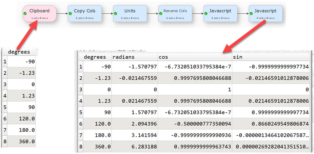

I have a table of angles in degrees and I want to calculate the sine and cosine of these angles. Can I do that in Easy Data Transform?
Currently, there isn’t a sine or cosine function in the Calculate transform. But you can do the calculation in a Javascript transform, e.g.:
return Math.sin($(radians));
The angle should be in radians (not degrees). You can do this conversion using the Units transform.
trigonometry.transform (4.6 KB)

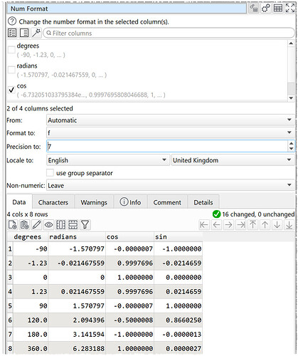

You can use Num Format to round off the values to a certain number of decimals.
