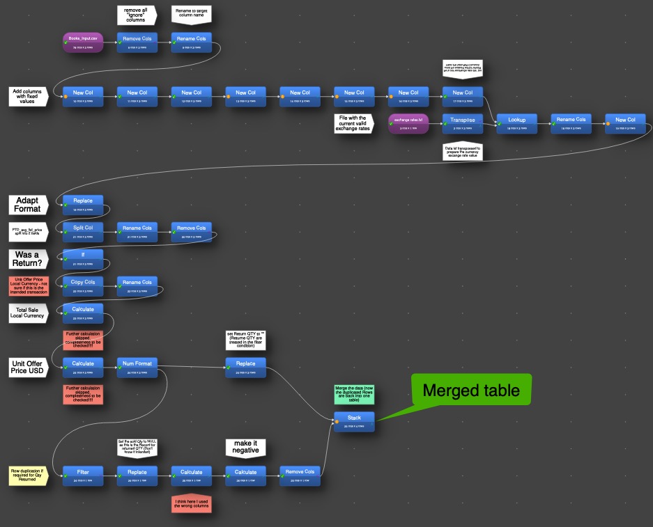

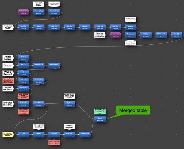

I executed some steps but not all of them, but it should give you an idea, so that you can complete it own your own. (in case you want to add transformations in between existing tasks make the connection arrow and than you select the transformation to be added). For specific topics you can ask.
What is done in the example:
First row: Data is read, ignored rows are removed and existing columns are renamed to target name
Second row: All Rows not existing with fixed values are set. The currency is added and the excange rate are taken form the exchange rate file with the current valid rates. (as I suggested before).
Then the Format Hardcover, etc is set (you need to check the mapping values) Further replace arguments can be added.
Split of the columns “PTD_avg_list_price” with 2 values is done. If I understand your explanation of the input data correctly. Resulting fields are renamed
Was a Return? Field is calculated
Unit Offer Price Local Currency is calculated, but I’m not sure if this is the intended transaction
Total Sale Local Currency calculated
A bunch of other calculations I did not executed, but the above should give you an idea how to proceed.
Unit Offer Price USD calculated. And afterwards start the little “trick” @Admin mentioned before.
The data set is now take unchanged and the Return QTY is set to NULL. In the second breakout only the records with a Return QTY > 0 are taken. For these the QTY sold is set to NULL. In three following steps the negative value for “Total Royalty Amount USD” is calculated and the interim column removed. Afterwards the to tables are merged again. And the duplicated rows are included. You need to check if the result insufficient in case all books are returned or if a further logic is required.
This should give you all ideas and help to complete on your own and write the result into a Excel file.

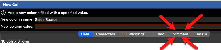

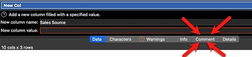

Don’t forget to add notes as much as possible, that you don’t lose track on your logic later on and make use of the Comment field in the transformations:

If you are uncertain with some transformations use the “?” to get the help, which is excellent (thanks @Admin for this).
In difference to @Monotone94 I keep the exchange rate in a separate file which can be updated daily, weekly or whatever. I’m not a fan to change an existing tested working transformation file (even if it is a clipboard). Through this the “.transformation” file can stay untouched. Therefore I suggest to use for the input file the same name for each execution. When you are familiar with the process and RDT there are more alternatives to process multiple files in one run with different name…

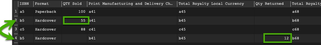

I can see how the comment about two rows might be confusing. Believe me, it is for me, and I’ve been doing it manually.
A row for the example report received contains both sales data for the period and book return data for the period.
When a book has both sales and returns in the same period, I manually take the one row and create two rows with the data. One row for the sales of that book title and one row for the returns of that book title. When it’s a return, today, I manually transform numbers to negatives. Essentially, one row from the source becomes two in the import sheet.
So, using QTY Sold as an example, if in a row, if a book sold 20 copies and then under the returns column, 5 were returned. In the sheet I manually created for import, there is a row that shows 20 in QTY Sold, and a second row that I added that has -5 in QTY Sold.
My example considers the row copy, only logic needs a change as it considers the return count as a positive number and not a negative number. An the calculation step multiply be -1 can be removed, too.
