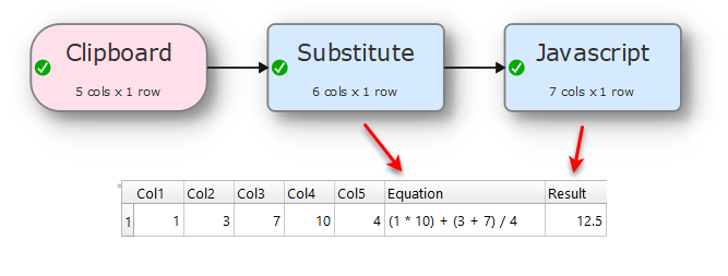

We did think about adding a Formula transform. But it would have been just a subset of the Javascript transform.
If you want to multiple column A x column B and add column C in the Javascript transform it is just:
return $(A) * $(B) + $(C);
Also the Javascript transform is surprisingly fast. Try it.
Here it is, you can do the following to make your formula transform.
Transform file.
FormulaTransform.transform (2.2 KB)
