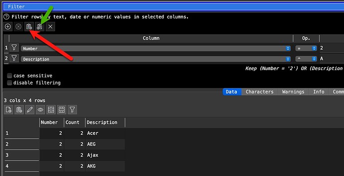

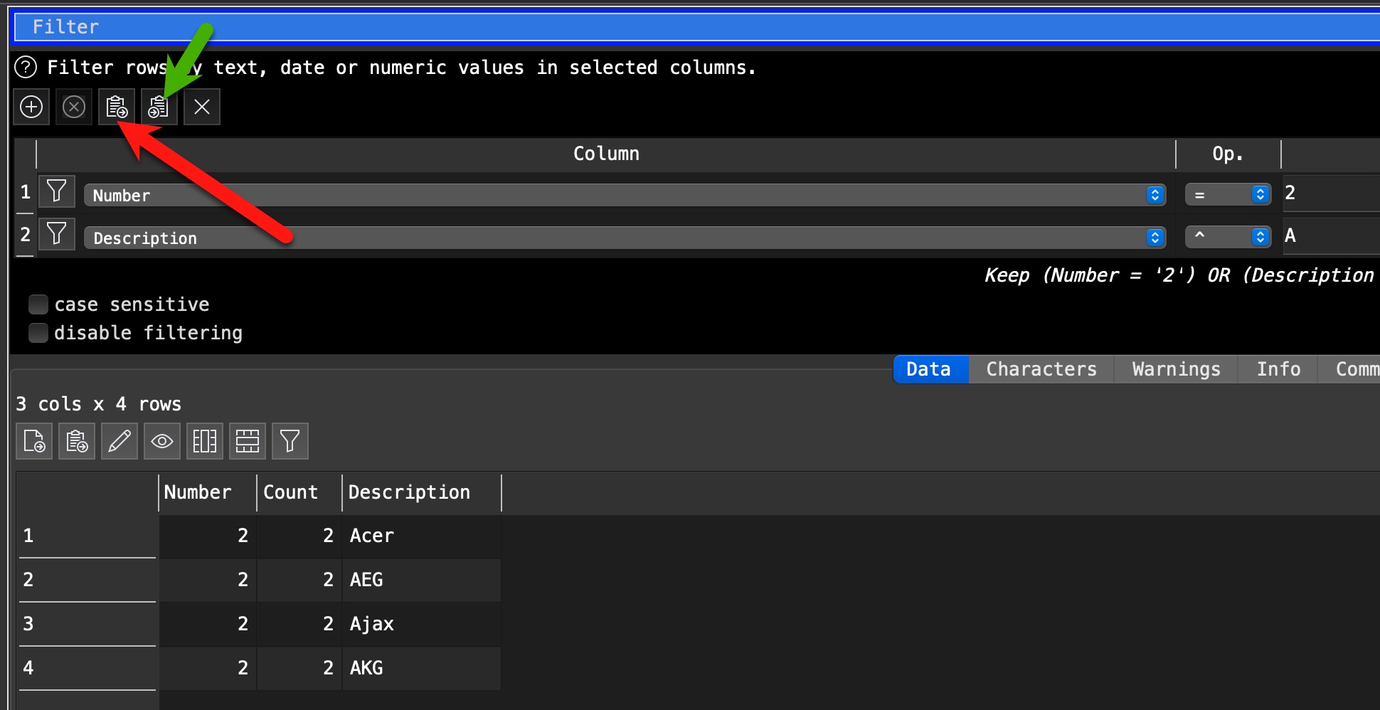

I agree to @Monotone94 it is unclear what you are doing.

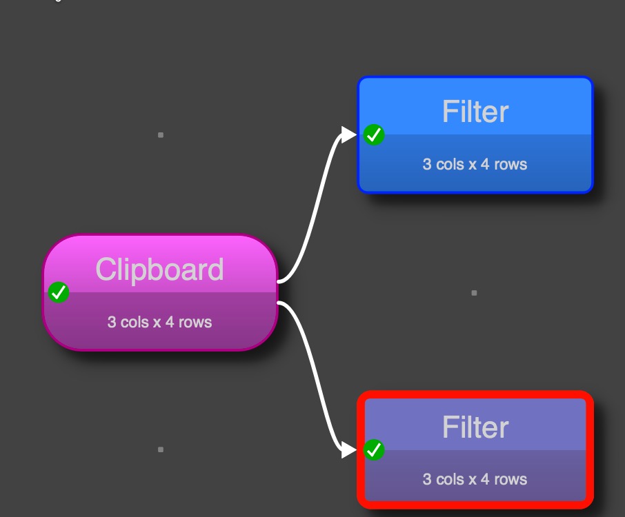

Did you copy from an existing filter (red mark) and past it in a different filter (green) again?
You need to consider that the filter clipboard includes EDT internal information and if this doesn’t fit 100% columns names are ignored and replaces by the generic ANY.
If it fits, e. g. in parallel filter to the first one, it works perfectly but the pasted filters are added to the existing filter criteria in the new filter statement.

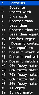

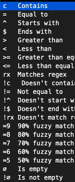

Now I start to speculate a little about what you are pasting from the Filter statements, but internally EDT works not on column names it use column numbers. I assume the term with the * address the column number, the second part after first comma seems to include the operation, e.g. = or ≥ … and the last part includes the filter value.
Middle expression, seems to take the number of the selection entries, starting with 0

1*2,2,Acer
Is:
  • column=2nd column of upstream node with Id=1
  • operation=2nd operation in list(=)
  • value=Acer
If you create some filter terms manually and copy them to the clipboard, you should be able to work it out.

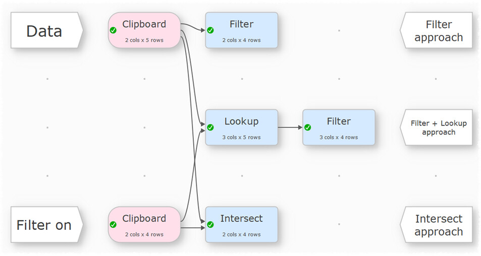

I have another question: I use a large number of filter terms (up to 500). Am I pushing the limits here? Would it be better to split the filter terms and chain together multiple instances of the filter function?
When processing large datasets, it’s somewhat difficult to verify whether EDT filters the data correctly. Therefore, I’m asking about the technically and theoretically possible solutions and any potential difficulties.
Easy Data Transform will easily handle thousands of terms in the Filter transform. But the user interface wasn’t really designed for that and it won’t be very easy for you to manage.
Consider using a Lookup transform instead. It requires more steps, but will be easier to update and to see what is going on.
The Intersect transform is another possibility.
lookup-vs-filter-vs-intersect.transform (5.0 KB)
