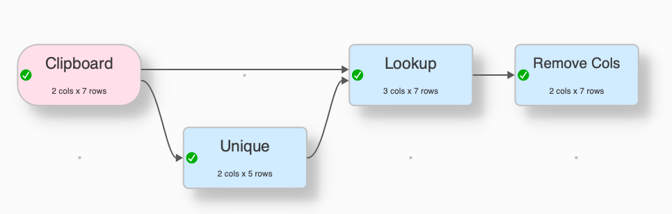

You can do it like this:
fillupdown.transform (3.3 KB)
You could add a Verify step to ensure that ‘Shipment cost’ column in Unique doesn’t have any commas (which it will if there is more than 1 non-empty ‘Shipment cost’ value for each ‘Shipment number’ value).

just a hint, the fill up and down works one as intended if the shipment numbers are in a sequence. In case they are unsorted/unstructured in the table the lookup solution from @Admin gives a correct result in any case.

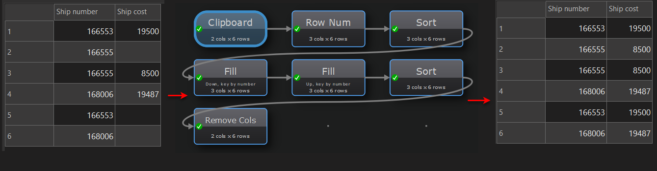

Here is the modified version of Monotone94 solution, that works with your example and keep the record intact in their original position.
Transform file
Modified_Fillbothways.transform (4.3 KB)
