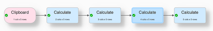

Hi
I have been using a function in Excel called “Trunc”, it simply extracts the integer from a number. How can I replicate that functionality in EDT
Thanks Bob

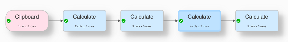

Hi
Thanks Bob
I don’t know a direct transformation for it, but you can use split column and split by the delimiter , or . (depending on what is you decimal separator). Afterwards you remove the second created column. The first generated column has the integer.
Hi
I need to use both new columns in calculations. How do I preserve the numerical format in both new columns? In the decimal, I lose the preceding 0. when the integer is removed
Thanks
I think if the loaded data the 0,22 is set you have the 0. If it is ,22 you are right the first value is empty.
Replace transformation with replace “empty” with 0 is your friend. See example transform file, too.
bobhabbijam example.transform (2.5 KB)
But column 3 is still not numerical.
Sorry it is numerical but does not have the right decimal in the calc
Can you show an example of what you are doining and what is the intended result?

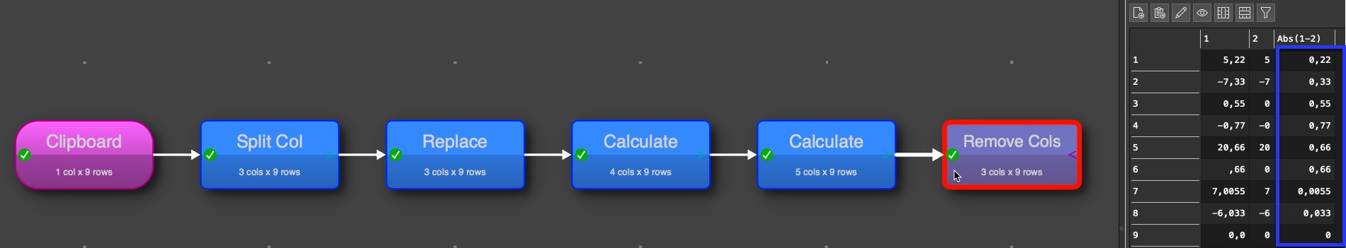

I need column 3 to be 0.22 - 0.33 etc so I can perform calculations
Thanks
Ok looks good, thank you Regards
Here is another approach using sign(), abs(), floor() and multiply to get the integer part:
trunc.transform (4.3 KB)

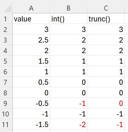

I will make a note to add it as a possible option for Calculate. I’m not convinced about the name Trunc though. Any suggestions for a better name?
Int or less often Integer are common alternatives.
True, Trunc is effectively a string operation. Perhaps it should be in that set rather than Calculate
