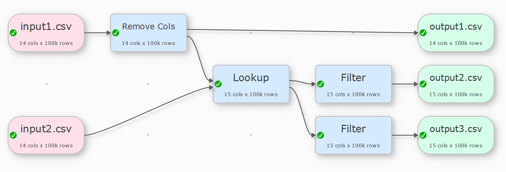

How would I best post an example? here is a partial of the one im working on. if you look at the top right, there are a lot of filters and lookups. if I break any link on the bottom left, even if I reattach, some of those filters go blank and the lookup loses the first value.
it would be nice if it just kept what it had until it saw the new data feed and then made the decision to break if the same requirements were not there. I would want that.

I strongly recommend not to break connection, if you can avoid it. Because that then nukes any column related parameters downstream (and it is hard to see how it could be otherwise). Instead try to delete and insert transforms without breaking the connections.
Also you can change the file and input item points to without deleting the input item.
Thanks. this helps a bit. What do I do in this situation? I added a lookup and some filters and then want the output of those filters to run back to the output. I have noticed that filters dont offer the + option to run an arrow out of them. Why is that?

It isn’t clear what should happen if you connect multiple transforms to 1 output. So an output item has a maximum of 1 upstream transform item (or input item).
If you delete the connection from ‘remove cols’ to your output you will be able to an input from one of the ‘filter’ transforms. But you have lost the original connection.
If you want to send the data from the ‘filter’ to a new output file, just add a new output with the filter selected.
If you want to send the data from the ‘filter’ to an existing output file, use a ‘stack’ transform to merge the various outputs and then output from the ‘stack’ transform.
