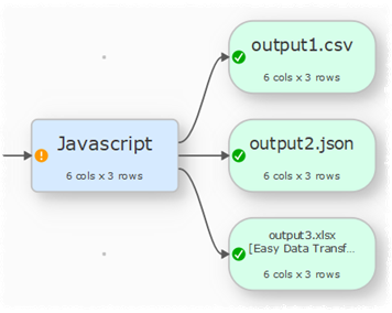

  3. You can have multiple output in same file without any issues , in different locations (believe it or not , I didn’t know this)
Do mean using append write?
I mean one output can also be put in multiple locations or in single transformation you can do multiple outputs
If you output to the same file multiple times in one transform without appending (or writing to different sheets of an Excel file) won’t you just overwrite your changes? Perhaps I am misunderstanding?
Or do you mean:
My (1 single) output is required to be in multiple locations for various reasons
C:\XYZ\1.csv
E:\Google Drive\Sync\1.csv
C:\support\backup\1.csv
All this can be handled in a single transformation . Expert tip here is it’s possible (which I didn’t consider)
Likes this?
Bingo ! that’s the expert tip it also can be done in 1 go , I took a surprisingly long time to figure this (ha ha)
