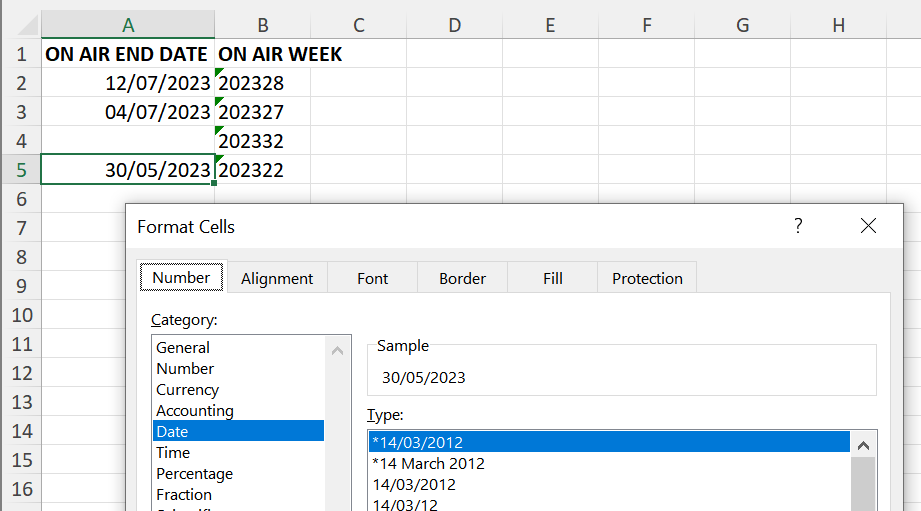

Despite the manual setting in the output file of a column whose format I want to be “date”, opening the output file, the format remain text.

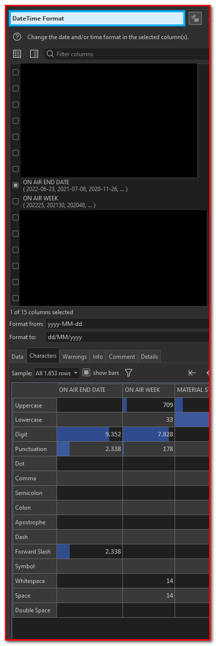

In order to solve this issue I tried also to add a new transform phase before output, the DateTime Format, but the situation didn’t changed, and I have some dubts and errors:
  1. in the “format from” filed, the date type isn’t automatically identified from EDT? If not, I have to set the format according to how EDT shows me this data, or should I open the source file and see how it is shown to me?
  2. in the “format to field” I setted the date format I preferred…Even if is ISO format as shown me from EDT…
  3. In the warning sheet, there are some errors…possible that EDT not identified the informations filled in this column as date?

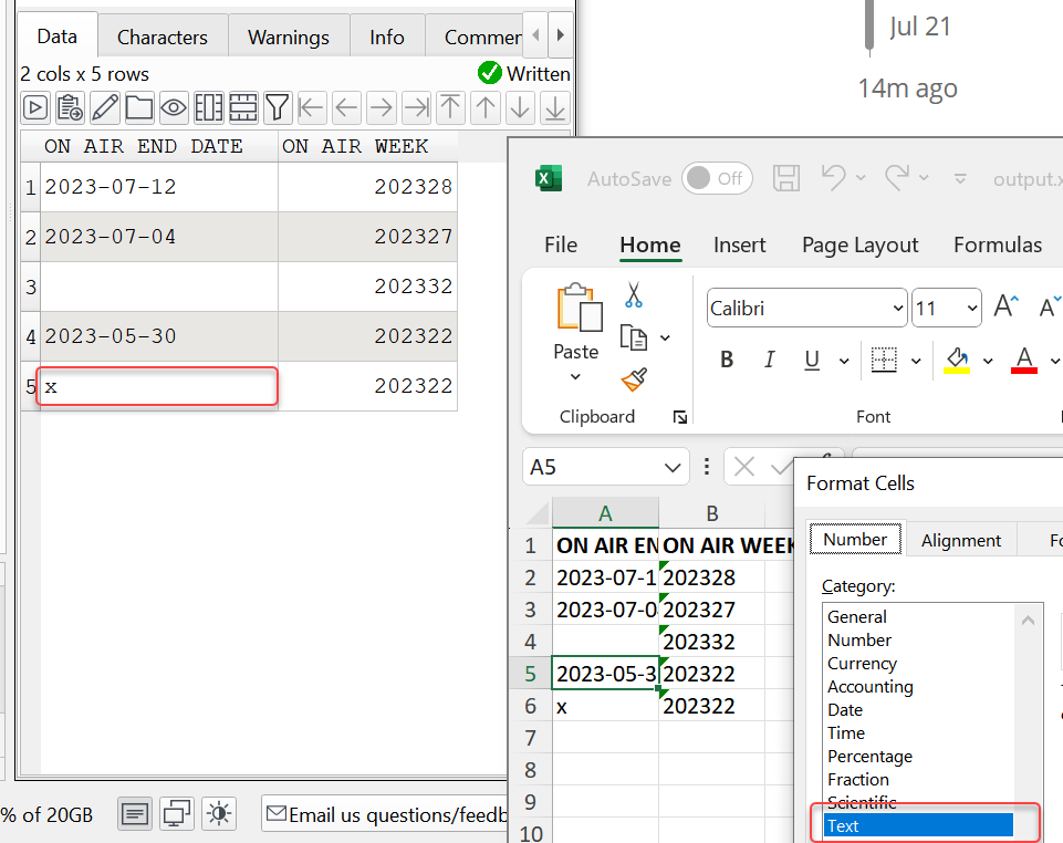

If I do this:
Then I get dates, as expected:
dates.transform (1.8 KB)

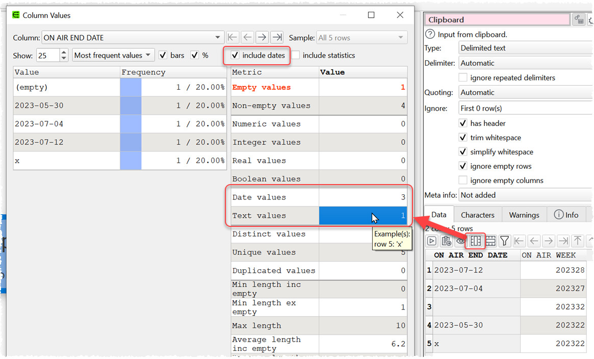

But if I have 1 or values that are not dates or blank, then it won’t set the column to date format:
You could argue that it should set date format for all rows where it can. But currently it sets the format for the whole column.
To find the values not recognized as dates you can do something like this and look at the warnings:
(converting from yyyy-MM-dd to yyy-MM-dd won’t do anything)

The problem is that when I open the output excel file, even if I will change by excel, the column format value from text to date, the information will appear wrongly like this:
Only using excel ASAP Utility addon, I’m able to transform these text informations into date.

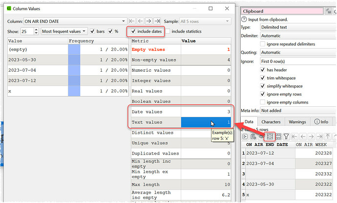

If you look at the ‘Column values’ window, does that tell you anything useful? Hover over text values to see a tooltip.

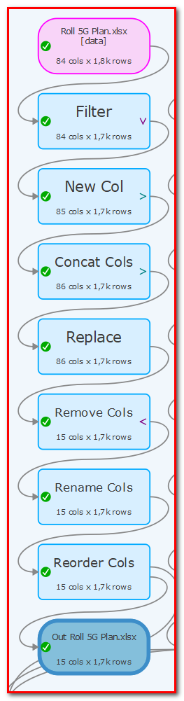

If I analize this column in the “Reorder Cols” before output, the informations are identified as dates:
If I check same information in the output file phase, they become text :face_with_spiral_eyes:
Seems that some things happened between the two last steps.
Thank you

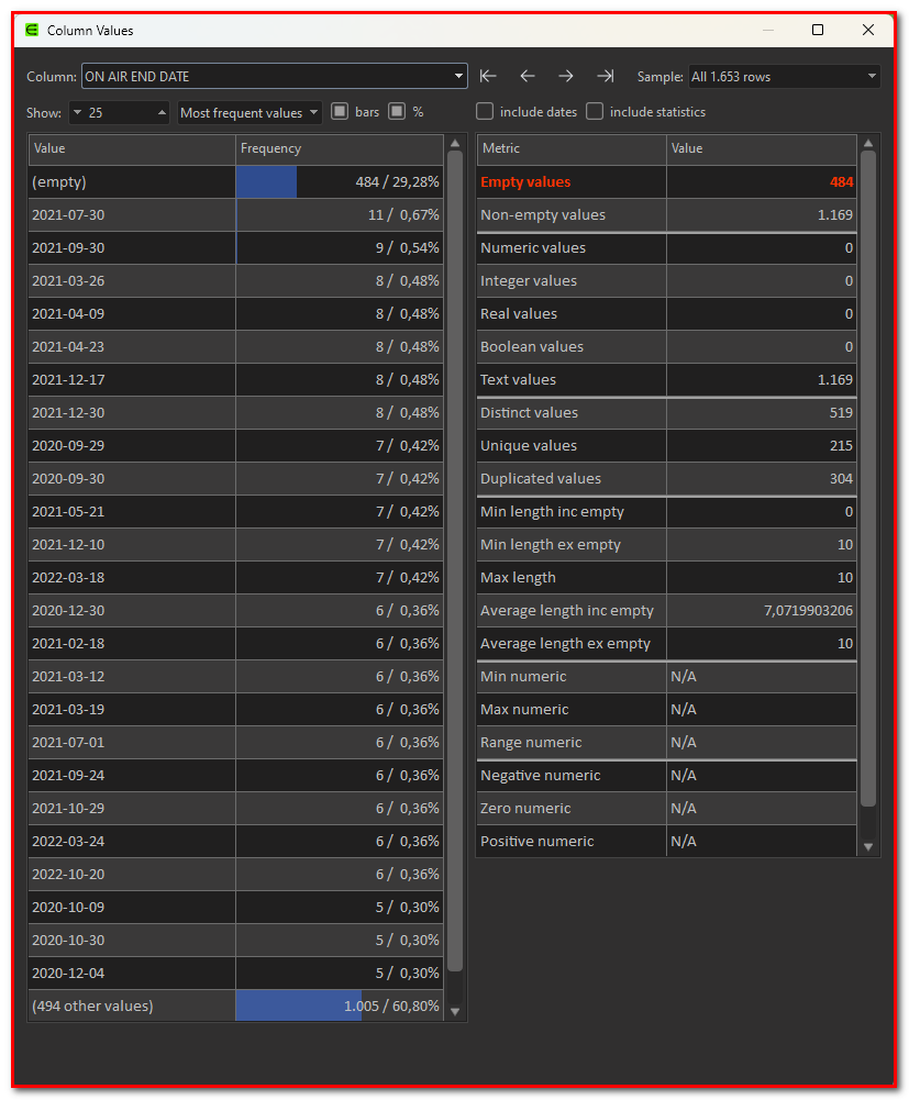

I had a dig through the code. The issue is that Easy Data Transform expects 90 out of the first 100 values in a column to be valid dates (not blank) for the column to count as a date column. In your data the first 100 values have 75 dates and 25 blanks. This is a bit arbitary and I will have a think about how we can do better.
As a workaround, are you able to sort on the date column so that valid dates are at the top?
Now before output to file, I added a sort organizing the date discending, and finally in the output xls file now the column is date formatting as requested in the manual formatting option.
