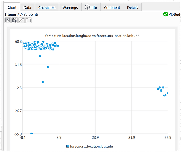

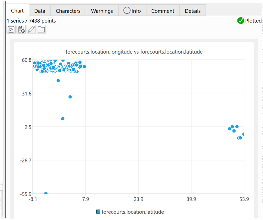

Something clearly wrong with the latitude and longitude of some rows:
For example, it has a Northern Ireland filling station in the Indian ocean. I think because they got the latitude and longitude the wrong way around.
A quick review in EDT :slight_smile: shows:
  • Latitudes min -55.861 and max 60.769
  • Longitudes min -8.096 and max 55.917
So lots wrong there.
Tighnabruich as an example (nice place, I nearly bought a static caravan there…) is 5.2403, but should be -5.2403.
I suspect they have some with +ves when they should be -ves, and lats and longs switched around.

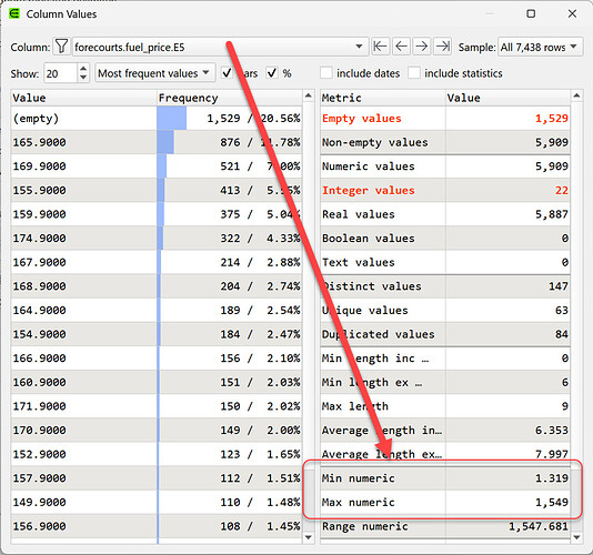

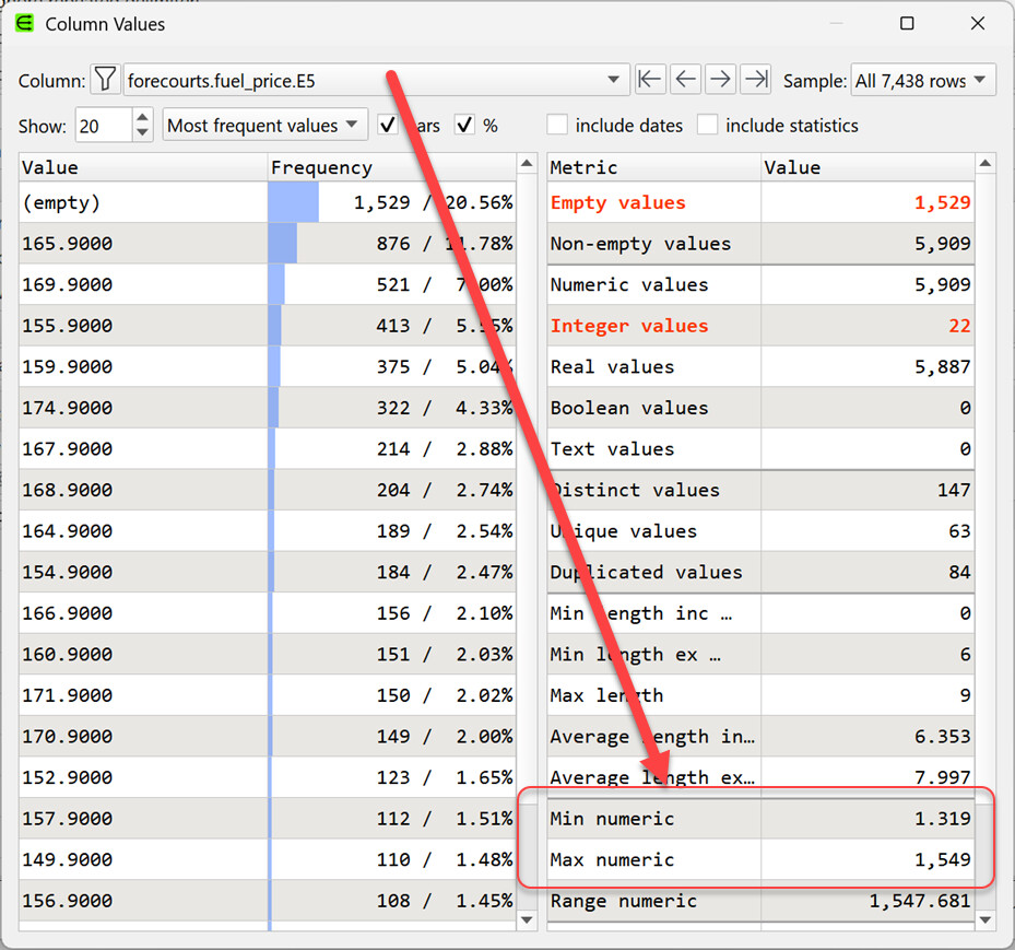

Also the most expensive fuel is more than 1000x as expensive as the cheapest:
I found this issues within a few minutes of loading the data into Easy Data Transform. So shame of the UK government for not doing at least some basic checks.
