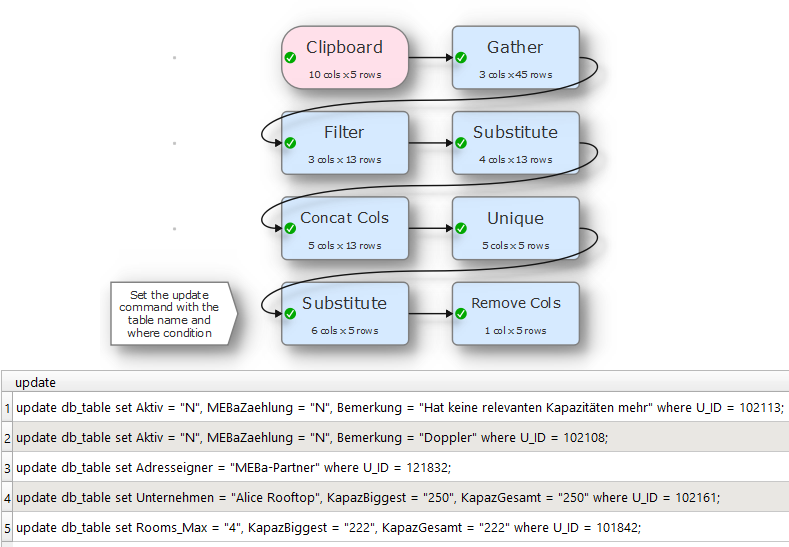

You can do this with Replace and a regular expression.
,?\s?\S+\s?=\s?“”
Here is my quick and dirty attempt. Someone might have a more elegant approach.
DocRolfo.transform (3.1 KB)
Ps/ The Substitute is only set up for some columns, not all.

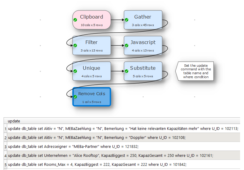

@DocRolfo,
Here you go.
Transform file.
Create MySQL UPDATE .transform (4.3 KB)
Interesting way to avoid regex.
BTW You might need extra steps with either approach if the data contains commas or quotes.
This way, one does not have to type the column names which was one of the requirement.

Anonymous, your way was very interesting - I never thought of going this way. I took your steps and added just one step: when the values are numbers/integer, they are not allowed to be inserted in “”. So I added one Replace and now the transformation is just how I need it to be!
I attached the file again - aaaaach shoot… I cannot upload files! Sorry, would have liked to show you.
Admin - as you said, your way was quick and I learned a lot about transforming text in easydatatransform. I also tried to work the restriction in here that integers need to be without “” but it did not work. I tried to add a third Replace field where I replace
,?\s?\S+\s?=\s?“\b[0-9]+\b”
with
,?\s?\S+\s?=\s?\b[0-9]+\b
but in Update statement it stays Rooms_Max = "4
I also wanted to attached the file - as I said above: no chance. Too bad.
Anyway, thanks for the help, guys… and I really have to get into Regex!

Here is the updated transform that will not put numbers/integer in quotes.
Transform file.
Create MySQL UPDATE .transform (4.2 KB)
Here you go with the solution provided by @Admin, by modifying it your requirement of numbers/integers not to be in quotes. Also I added all the columns.
Modified Transform file.
DocRolfo.transform (3.4 KB)
