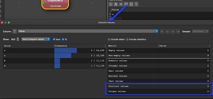

isn’t this sufficient?

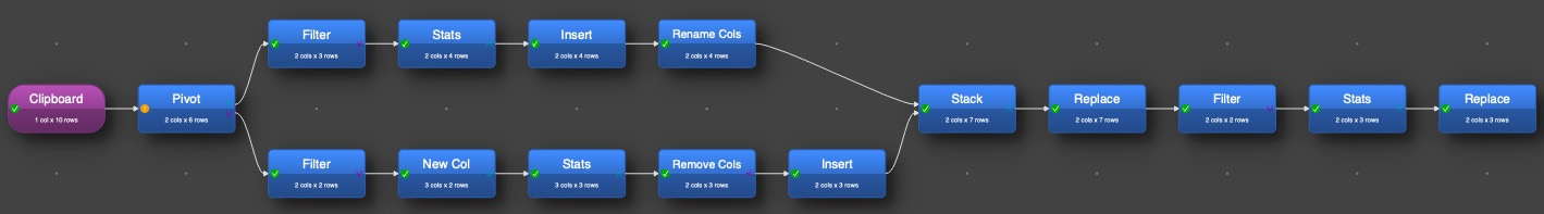

little more complex … maybe the pivot gives you already what you need and the rest is not needed
distinct.transform (7.7 KB)

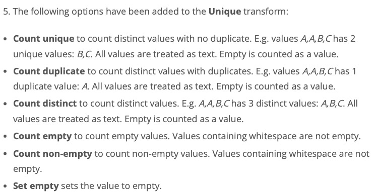

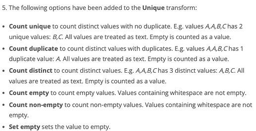

There are additional Unique options in the latest snapshot. Please try them and let us know if you have any issues:
Edit Fixed incorrect link.
I don’t understand the new options, can you kindly explain.

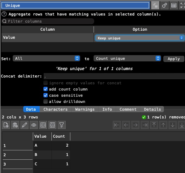

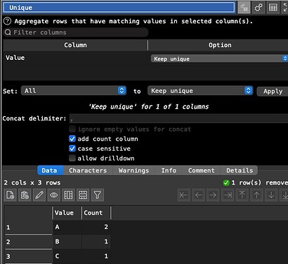

I created following input table:
using unique:

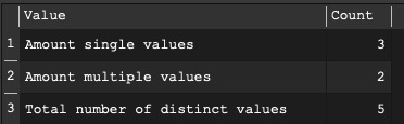

Output is like a pivot with count

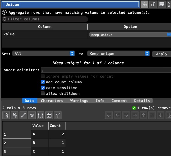

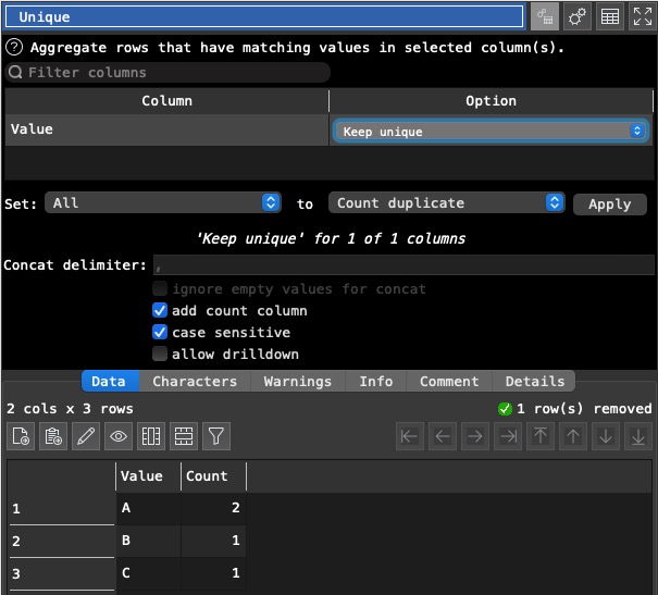

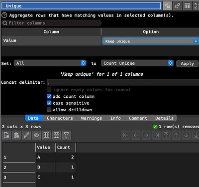

If I try now other options I don’t get what’s going on:
It shows all the time the same.
You need to press the Apply button to get the option applied to the table.

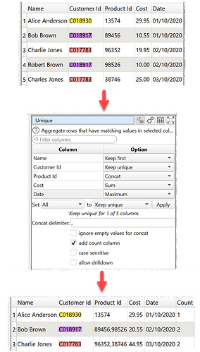

Unique isn’t very useful unless you have at least 2 columns.
If you have a dataset like this:
Key Value1
001 A
001 A
001 B
002 C
002 D
And want to count how many values in Value1 are unique for each *Key value:
So:
  • Key=A has 1 value that occurs once (B).
  • key=B has 2 values that occurs once (C & D).
If you click Add count column, it will add an extra column telling you how many rows in the input dataset make up each key column.
Ps/ Keep Unique is not a particular good name. It should perhaps be Key column. And the Unique transform might be better called Aggregate or Group By. However we don’t really want to do major renaming, except perhaps during a major release.
Thanks for explanation, now I get it. I suggest to add the explanation with the 2 columns minimum and so on to the documentation. In a few weeks I will be lost again.
Hopefully this example in the documentation helps:
I will look at adding another example and see if I can do anything to make the UI clearer.
