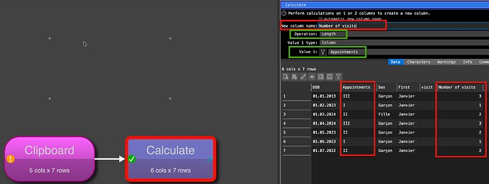

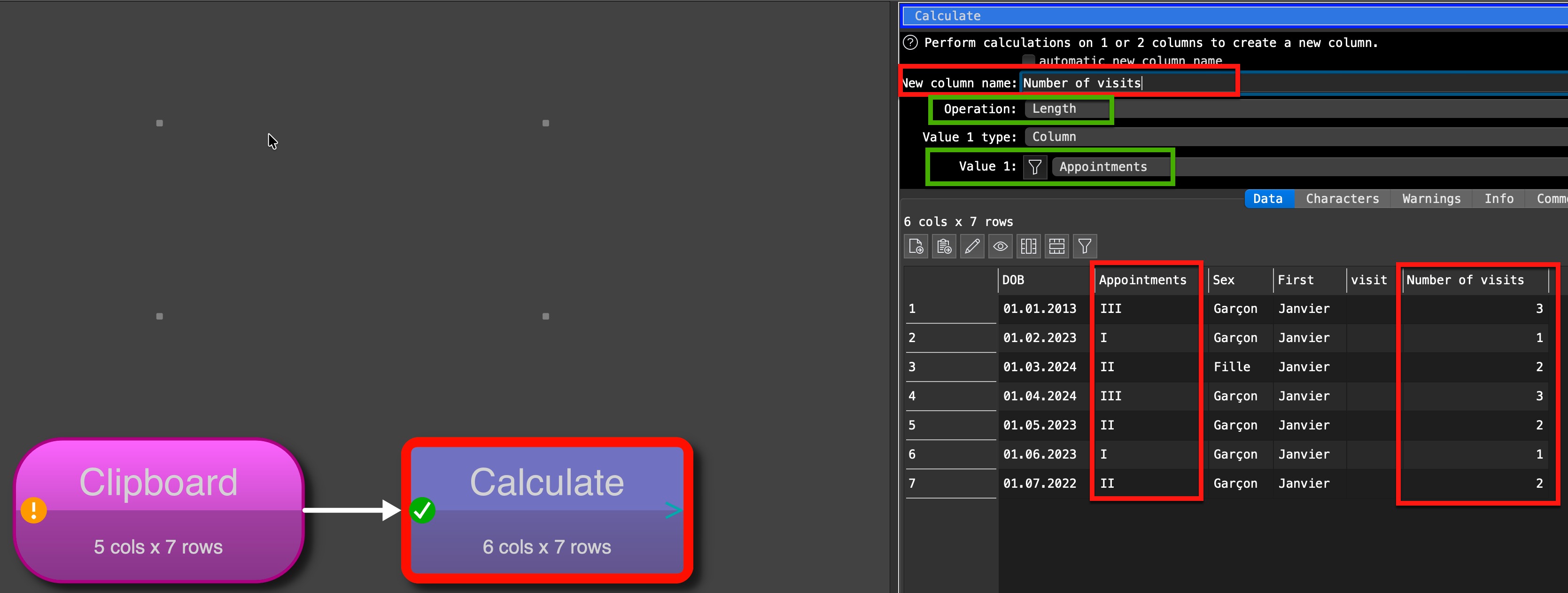

If Appointments is own column in the Excel sheet it is easy. Just use calculate and get the length of the Appointments column:
Visits.transform (2.3 KB)

Yes, the “I”s are in their own column .
Simple, elegant and brilliant solution-so many powerful transform options in EDT.
Thank you again

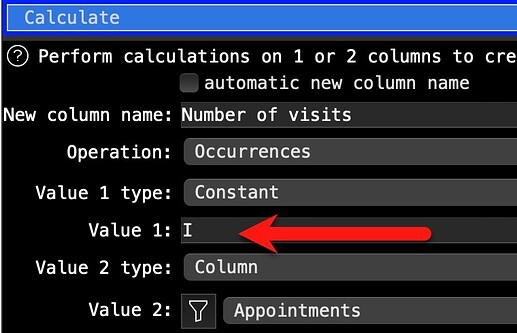

I looked into the calculate transform and thought that using “Occurrence” could be a better option, as it should report the number of occurrence of a string (character) I, with the idea that spurious spaces may appear in between the “I”s. I used as a constant I (then “I”, without any changes) unfortunately this results in 1 if the column contains just one I, and 0 if there are multiple “I”s (II, IIIIII, …); empty field yield an empty result.
Am I missing something?

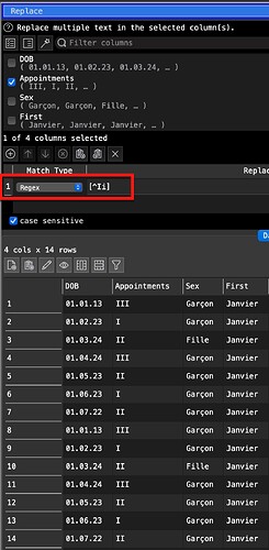

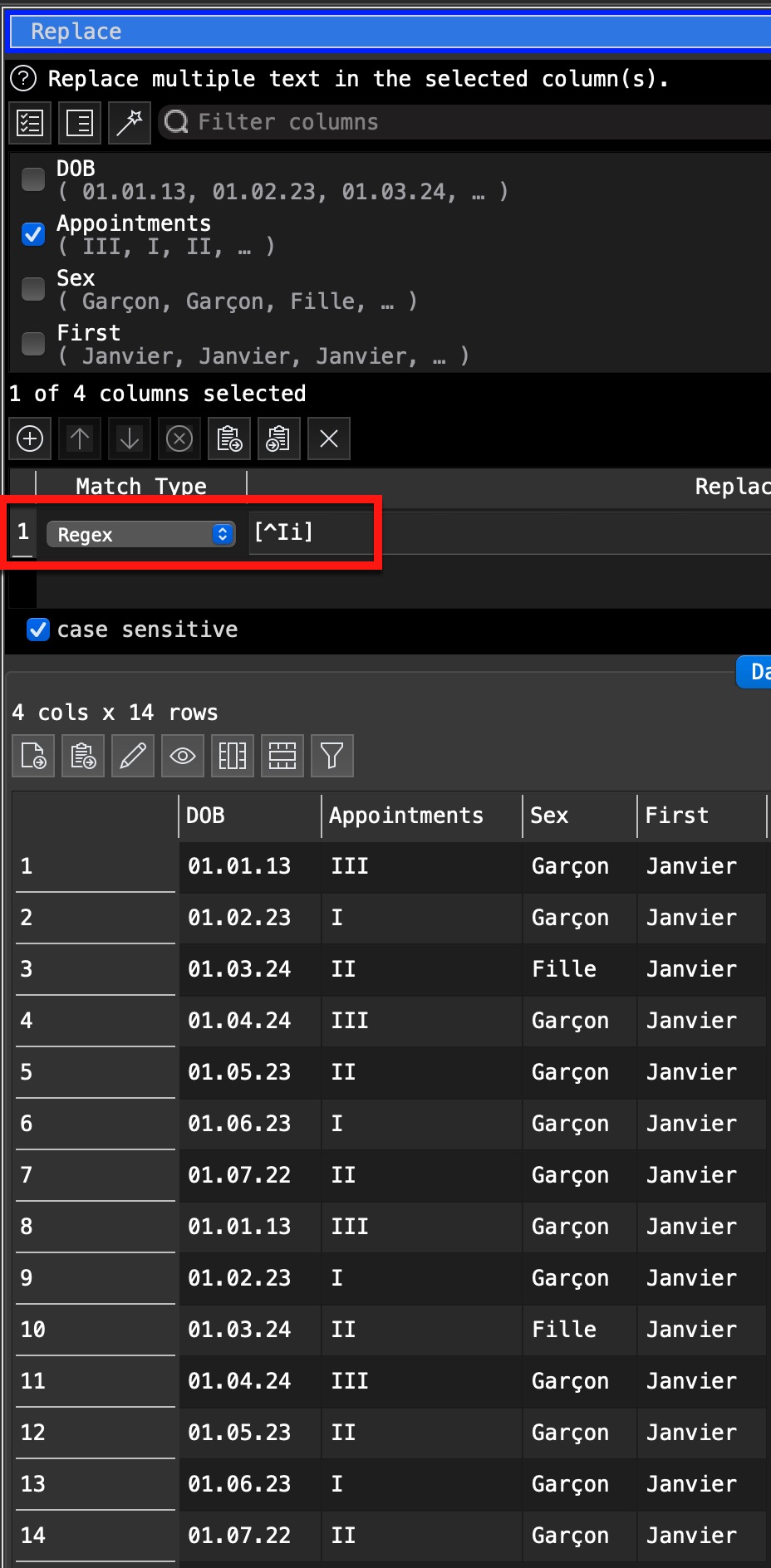

it is an excellent alternative, It will ignore any character beside the “I”s. But you have to consider it is case sensitive in case you have “i” it will be ignored. Another alternative could be to use Replace before the calculate and replace unintended identified character by ““ (nothing) or a Regex replacing everything beside “i” or “I” with ““.
here added in the Appointment column blanks and other characters between the “I”s.

With the “occurrence” approach there is possibly a bug, as only “I” are identified as 1, Not “II” (gives 0) and all the others “III”, “IIII”, and so on…
For me it is working as expected. Check the Botton part.
Visits2.transform (5.4 KB)
It includes 3 different approaches.
Maybe check if in the Occurrence value a blank or something else is added
Thank you for showing the transform - it was my mistake, I had as value 1 the appointments and as value 2 “I”, and therefore it was working perfectly, matching only “I” and “I”…
Switching them around works like a charm.
