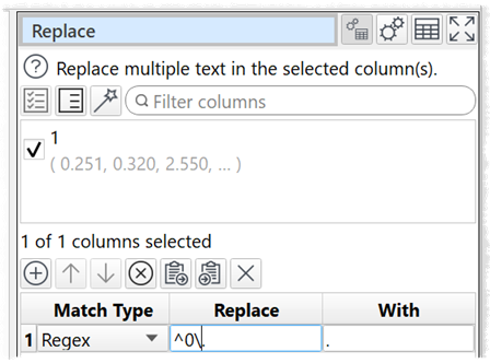

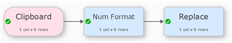

You can do it with 2 transforms:
baseball_formating-2.transform (2.4 KB)
This:
Replaces anything starting with “0.” with a “.”.
It is also possible to do it without regular expressions, but it is likely to take more transforms.
