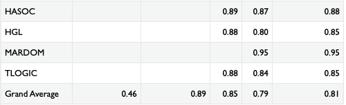

That’s correct — using CALCULATE is tedious. For example, this is just a utilization value (a percentage).
I was considering using NUMFORMAT, since only the display format needs to be adjusted.

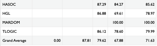

but I tried scale and I am getting a different answer.
Miguel
Scale won’t work for what you want to do.

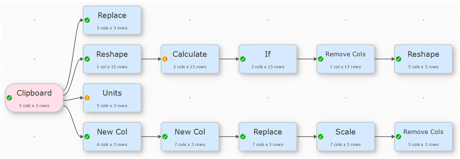

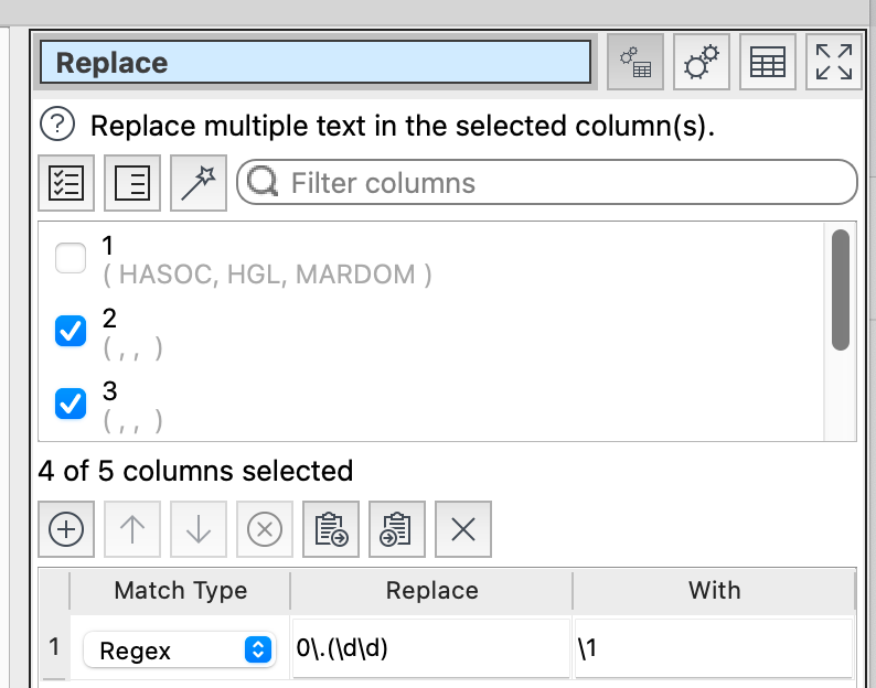

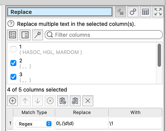

I have come up with 2 fantastically hacky ways to do it. One involving Reshape, which is rather long winded, and the other uses Replace and a regular expression.
See:
multiply.transform (3.6 KB)
Are these values created by a Pivot transform?
And here is a truly revolting hack - use Units to convert Meters to Centimeters. That will multiply everything by 100!

Here is one way of doing it, you don’t need Replace if the columns are not blank and have 0 in them.
Transform file.
AddingPercentageInNumformat.transform (3.8 KB)

If you want to use Scale, you need to ensure that the data contains a 0 and a 1 to scale the minimum and maximum against.

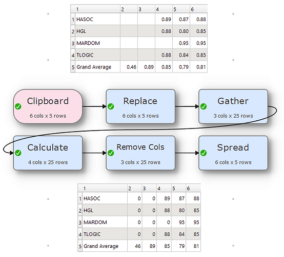

So that gives 4 ways to do + @Anonymous 's method using Gather and Spread.
multiply2.transform (7.4 KB)
