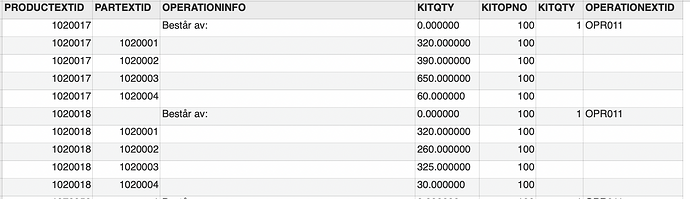

Here is a snippet of the actual data I am working on:
The first two columns there are my ID and SUBID columns, that I want to match up, and have the INCREMENTAL column (KITOPNO) be 100 or multiples of that if SUBID is duplicated within the ID.

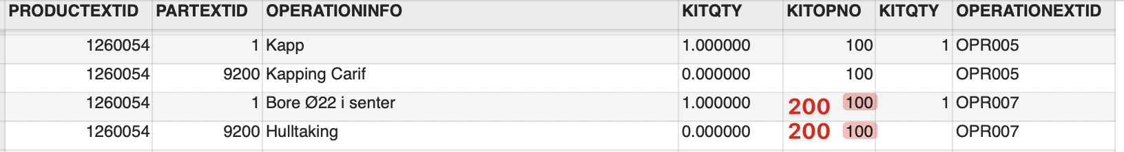

So these data are wrong, the wanted INCREMENTAL value added to the screen clippings here:
Was that better explained?

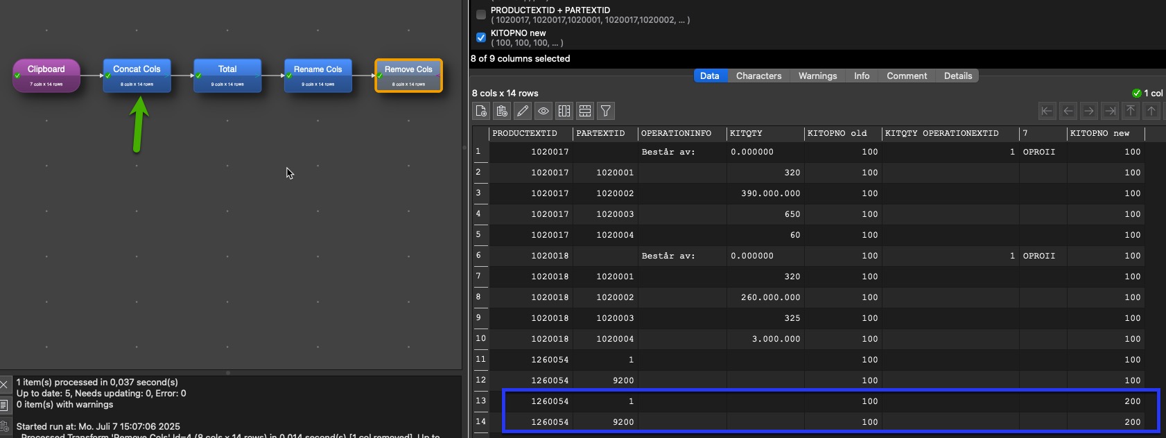

The trick is the Concat
in the transformation file I renamed the original KITOPNO to KITOPNO old and the new generated one to KITINO new (last column)
Column values egilDOTnet.transform (3.6 KB)
This is basically the same approach as @Olaf.
KITOPNO.transform (2.9 KB)
If we have misunderstood you might have to give some better example data.
