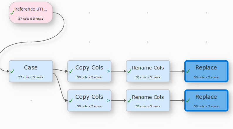

Hello, Is it possible to concatenate replaced values for example I have an original photo value from where I replace .jpg by 1.jpg than another replace from the same original column .jpg by 2.jpg and I want to concatenate both result into the original value if possible or into a new column ?
Regards
If I understand the problem correctly, you can:
- Use Copy Cols twice to make 2 copies of your ‘photo’ column.
- Do a Replace in each of the copied ‘photo’ columns.
- Then do Concat Cols to concatenate the values into a new column.
- Finally do Remove Cols and/or Rename Cols to tidy up.
Does that help?

If I select both Replace box I cannot select the Concat Cols porcess ?
regards
You can use Stack or Join depending on whether you want to merge the two datasets on top of each other or side by side.

And the result is not correct why please?
I am waiting for 000014731.jpg|000014732.jpg and the result is 000014731.jpg ONLY ! I Don’t understand !
Regards
Hello,
And the Stack process duplicates my records ! So It is not good !
Regards
I am guessing you probably want to use Join to merge the two datasets side by side (rather than Stack). See:

I believe the attached does everything you want (as I understand it). I used a bit of Javascript to create the photo names.
colors.csv (61 Bytes)
fifisave.transform (5.9 KB)
Reference UTF Comma-Sample.csv (1.3 KB)
You will need to edit the colors.csv file to add the missing colors.
